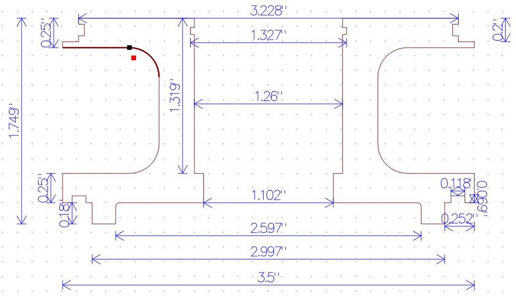

  #239
Old 01-08-2020, 08:08 PM
Join Date: Mar 2009
Location: Plano, TX
Posts: 2,089
Originally Posted by rocketbob View Post
Yes that would be great.
Would like a drawing of the shaft as well. I think it would be ok to make it out of 4140 or 8620 steel.
Bob,
Sorry for the delay. Here is my housing drawing in inches. I don't have a detail drawing of the shaft since I repurposed one from a slick mag.
Colin P.
RV-6A #20603
Complete 5/10/19
PP SEL / A&P
  #240
Old 01-14-2020, 03:38 AM
rwtalbot rwtalbot is offline
Join Date: Feb 2006
Location: Sydney, Australia
Posts: 251
Originally Posted by WingsOnWheels View Post
Bob,
Interesting, so you have an O-ring seal at the top or is that grove for bearing retention?
How are you attaching the gear to the shaft? Loctite 638 might be an option with interference fit, or is there still room for a grub screw? There must be a secure solution involving a minimum of machining. It looks like Dan may have used grub screws.
