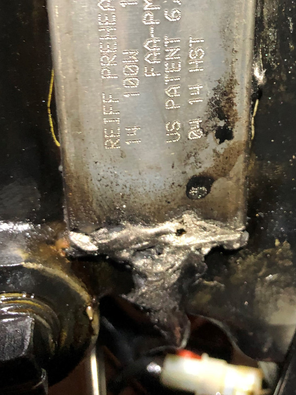

Originally Posted by Dean Pichon View Post
Hi All,
My engine oil sump heater died the other day. I had originally installed it in 2002. Unfortunately, the manufacturer, Symtec (www.symtec-inc.com) no longer makes sump heaters.
A Google search turned up units by E-Z Heat and Reiff for aircraft and a number of systems for ground based applications (e.g., Zerostart, Kat's). Any experiences, good or bad, would be appreciated.
Dean
My experience with Reiff heaters and more importantly their service, was poor. Their product burned out after an estimated 20-30 times used over three years. They carry a 5 year warranty, but Reiff wouldn't honor it since I didn't purchase the kit and it's apparently non-transferable. They also felt like these were not installed properly (not enough epoxy used). That could well be, but if they replaced the $20 pad under a courtesy warranty, they would have had a customer for life. I'll try E-Z Heat on my new engine.
Brian J.

If you need real heat for truly cold weather operations, the Reiff Turbo XP system is hard to beat. It puts a pair of pads on the oil sump, a pad on the oil cooler and bands around the bases of each cylinder.
Our aircraft lives in a hangar that would be better equated with the term "farm implement shed" than "hangar". Temperature indoors is exactly the same as the outdoor temperature. At -20C I turn on the Reiff system before going to bed the night before. With an insulated cowl cover the engine is ready to fly by first light, with oil temperature typically around 100F, "in the green".
The nice thing about the Turbo XP system is that it packs enough watts to heat the whole engine in a relatively short time. When it's really cold, installing a couple of hundred watts doesn't cut it unless one is very patient and an excellent cowl cover is used. A clear indicator that you've not got enough heat in the engine is that oil temperature declines after start-up. This says the warm oil is being pushed through a cold engine. In milder climates this may not be seen very often. In truly cold climates this symptom is often seen, and is a clear indicator of insufficient pre-heating.
With respect to the post above concerning poor service from Reiff, they're a family-owned and operated company so I'm surprised they didn't go the extra mile. Looking at the photos provided it's clear the heat pads have far less than the recommended bonding agent applied to them.
It's pretty obvious the installer didn't even come close to following the installation instructions. That goo under the pads performs two functions... Firstly and obviously it bonds the heating pad to the metal oil sump. What most folks don't clearly understand is that goo also performs the critical function of facilitating heat transfer between the pad and the oil pan. Not enough goo means the heating element can't get rid of the heat it's making, leading to burn-out.
In this instance the burn-out of that heating element has a cause which is pretty obvious. If I were the manufacturer I'd certainly hesitate in providing warranty replacement, and perhaps more so to a person other than the original buyer.
Whatever path you follow moving forward, I hope you have good success. Success is largely dependent on quality of installation, as we've seen from photos above.
