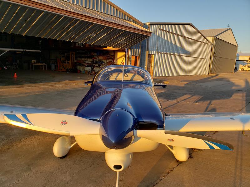

I used Nason Fulthane single stage paint on our -8 with good results. I read the technical documents, read a few comments from pros and practiced on a condemned -6 tail. The price is reasonable and it's easy enough to spray even using an inexpensive (Harbor Freight) spray gun.
https://photos.app.goo.gl/9eQBPnnVfta1BmrU9
