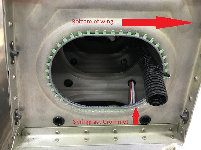

Van's Tech wasn't excited about me drilling another hole in my ribs. They didn't say I couldn't, just didn't like the idea. So, I used SpringFast flexible grommets and Van's conduit. I contacted SpringFast and they stated that I could use as little as 1/3 diameter of a circle and the grommet wouldn't move. I used about 1/2 diameter (look hard on second rib) on the internal ribs and a full grommet on each end rib. Clears bellcrank, servo, pushrods, etc. with ease. Conduit is yet to be trimmed.
