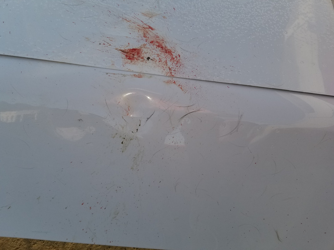

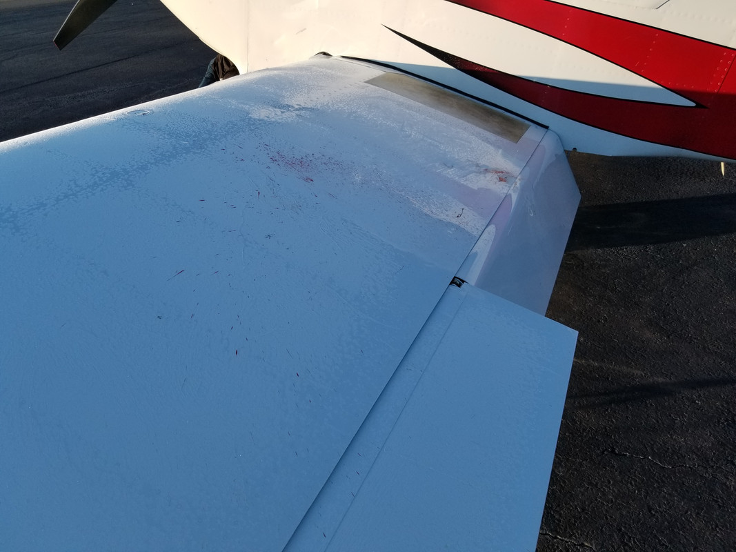

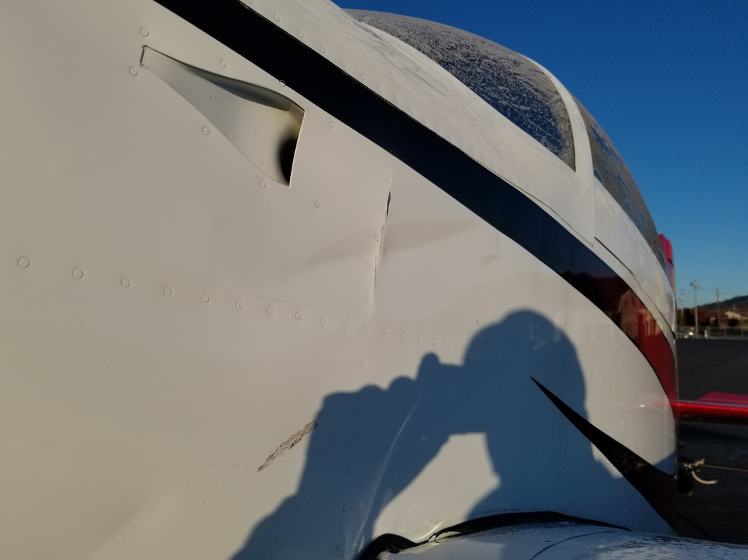

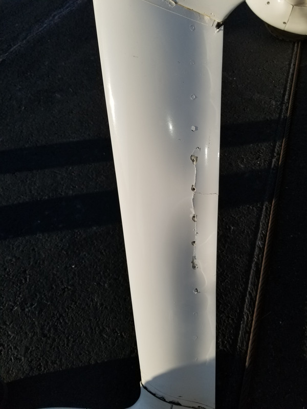

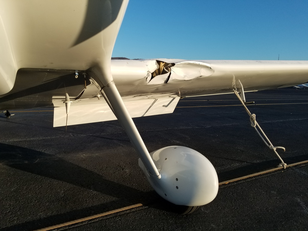

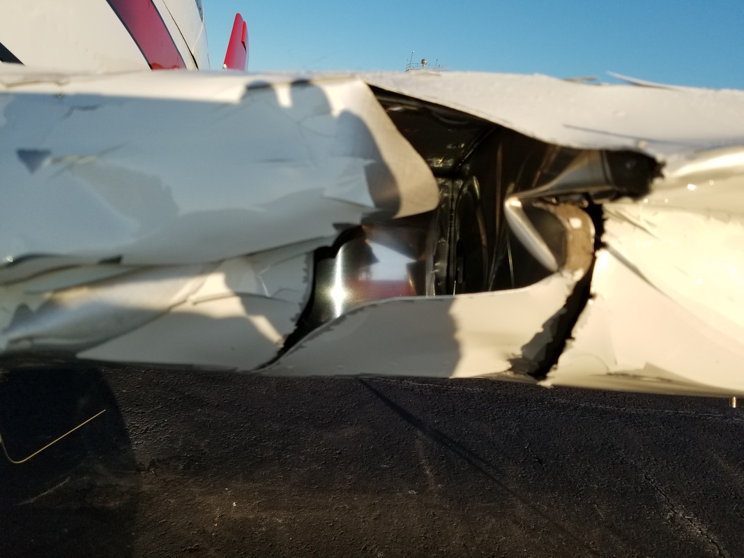

Old 11-24-2019, 09:02 PM
Av8safe Av8safe is offline
Join Date: Jun 2019
Location: Valparaiso, Indiana
Posts: 60
Default Didn?t look any better in the morning
More photos...wouldn?t buff out and not enough duct tape either...

Posts: 5,118
Originally Posted by sailvi767 View Post
I am sorry for your loss. It got to be difficult to deal with. I think given the need for a engine tear down, new prop and airframe damage it might be considered totaled. I would push for that option with the insurance and then look at a buy back of the aircraft. It?s certainly repairable and since the engine was at idle a tear down will hopefully find no internal damage. A deer strike is one of my nightmares!
G
The carrythrough spar in the fuselage will likely tell the tale on that decision. Engine and prop are obvious, the firewall and first aft doubler will need attention, likely replace the engine mount too since the engine is coming off and with all the vibration. The left wing is the question, if it's just the fuel tank then it's not so bad, as long as the spar and carrythrough are still true.
