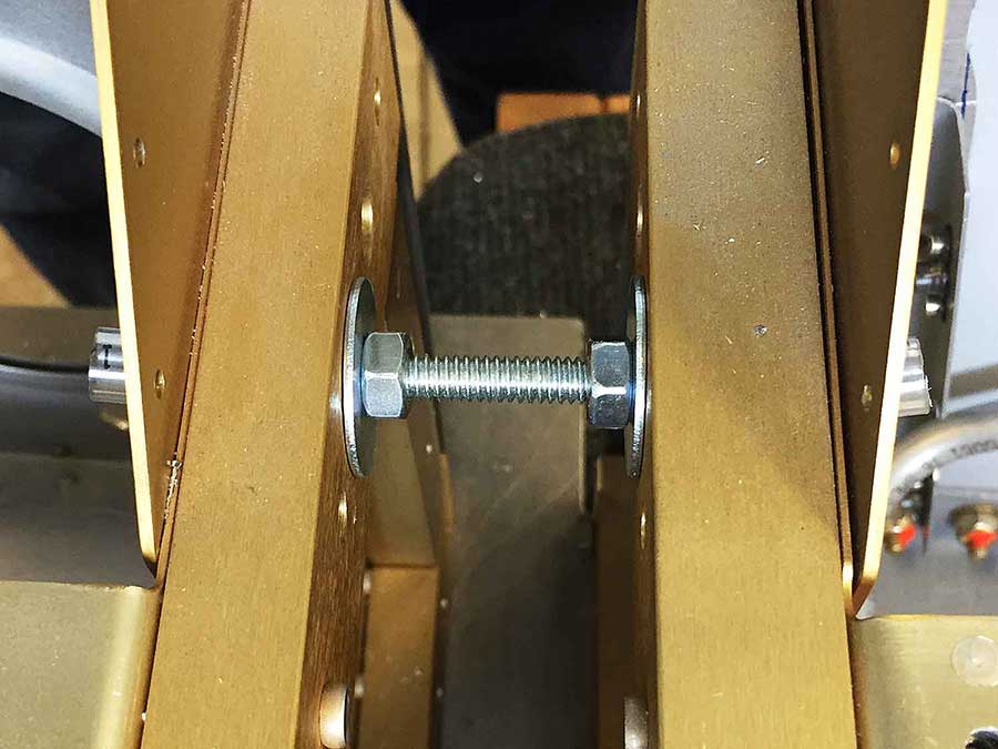

So here's my attempt at a center section spreader.
I tried ⅜" all thread but felt like I couldn't protect the burnished holes as well as I liked. Any plastic tubing I put on the threads was to large for the 7/16" holes and putting tape on the threads was a pain.
So I'm using ?" all thread. this allows me to have plastic tubing on the threads and as I snug up the nuts, the nuts push the tubing deaper in the hole...protecting the hole at all times.
I'm hoping this will be more controlled than an axe handle

Well I did a test to see if this affair would help with the narrow center section problem and it was a success.
I took a series of measurements with an inside gauge before and after putting some pressure on the center section and I easily gained .050". This was at the top of the center section and will give me the clearance needed to fit the wing spar.
I have not attempted to put pressure on the lower center section and will only do so if this method does not work.

That looks good Michael - making measurements indicates you are being careful. My bolts were a bit different in size but this will do the job, and you can remove them when the wing spar is partially inserted.

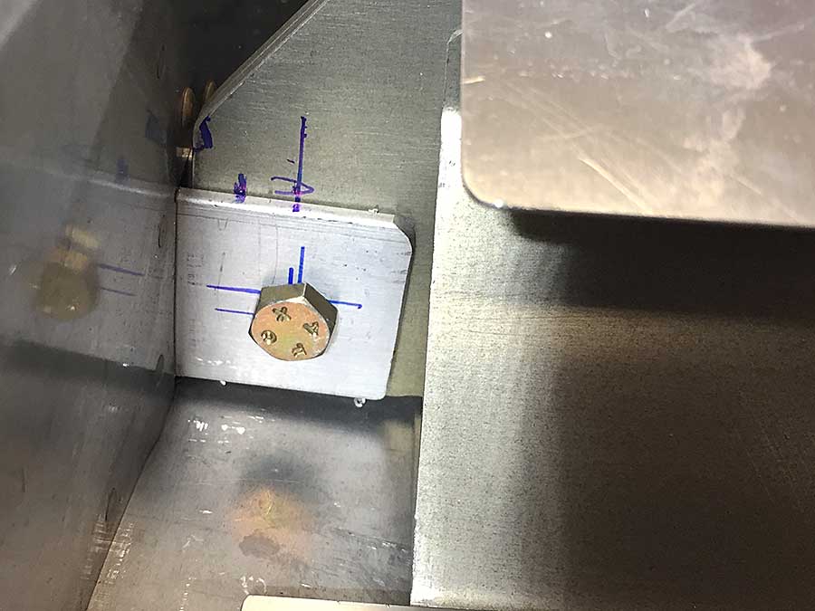

Thumbs up Wing Fitting Success
The wings are hung and the rear spars drilled.
My little spreader device worked like a champ. the main wing spars slid in with no trouble. the spreader was removed after the main spar was inserted into the center section and the spar was slid in the rest of the way.
The sweep and incidence were set but I could not get better than a ?" forward sweep. The left rear spar was hitting a fuselage rivet, stopping the wing from coming further back. I slid the wing out of the center section enough to relive the rear spar were it was hitting the rivet. This brought the forward sweep to 3/16" and allowed for a more generous edge distance. Although the right wing had only a 3/32" margin for edge distance....kinda scary.
If the photos don't show, just do a refresh until they show up.
Here's the left main spar just after removing the spreader.
Here's all four drift pins inserted into the left main center section.
Checking the plumb bobs.
Here's the left rear spar with the section relieved due to the rivet.
Checking wing incidence angle.
The rear spar drilled and the bolt installed
