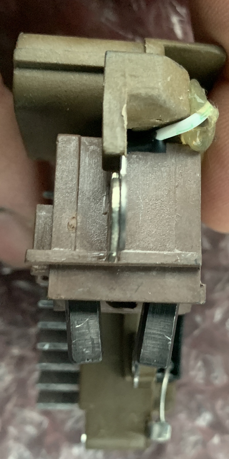

Maybe you could post some pictures of each unit to aid in identifying their respective origins?
FWIW, I have heard that the Plane Power OEM is Unipoint. However, I haven't been able to prove or disprove that.

Ok, here's some pics and info.
First, comments:
Vic, I hear ya. The thing is, your data point probably isn't worth anything in the discussion. (ABSOLUTELY no insult intended) The reason? Well, your B&C being 10 years old isn't the same model as what they sell today. That's exactly my point and concern. The highly positive reviews may be based on more reliable hardware than what we have for choices in 2019. If they still sold that one, I would have gone that route, for sure, because you're right...your generation of alternator had good reliability. Don't feel bad though, that's the same reason my 70A PP isn't worth talking about much. It's been more reliable too, and isn't the same animal.
Regarding Bob's question, I think both of mine were made after the change in ownership, although I can't say I know when that was. The one that failed with a bad stator short was installed in 2015 before I flew. The one that failed now was one that I got from another builder in 2016, who was building his plane. I stole it when I was AOG and sent him a brand new in box one. So I guess to be honest, I don't know the exact age as it's not printed on the alternator, to my knowledge. Hearing they made recent improvements, I would feel better about new ones than old ones I guess.
Regarding Mehrdad's comments, that's not what I found when searching threads. I didn't hear much of anything about failed regulators in the PP's, but heard tons of connector pin failures, and many stator coil failures. The connectors being the same as the NEW B&C, make me wonder if we won't start hearing of failures in those now too, simply because it's a different connector than those like Vic would have on his plane.
Anyway, here are some pics of them side by side. The PP has a larger bump on it's back shroud, but otherwise dimensionally they are the same. That's cosmetic because there's nothing under the bump. Also, the cases themselves are nearly identical, but, the mounting area is beefed up on the PP with some machined pieces. Makes it LOOK heavier duty, but in practice I doubt it does much. The other difference is just the pulley. Otherwise, you'll find them almost clones of eachother.
