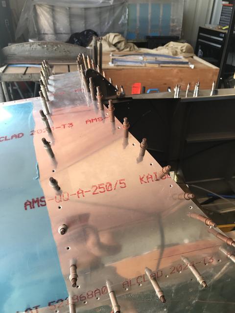

I didn?t think to mount it up and check it out first. I haven?t trimmed it yet so I?ll do that before I do trim it. The first step in the instructions is to trim the vertical but I skipped it. Now I can mount it and see hon much I need to remove.

I have a recollection the desired angle ended up trimming about .75" from the nose. Some people have re-used the original Vans nose rib. I chose to make a new one from scratch for two reasons.

A Vans rib didn't fit right when tilted up, but it's very easy to hammerform a new one which does. Trim the VS skin, hold an MDF block against the edge, trace the shape, cut the block inside the line, sand till it fits loosely in the skin. Round the edge, cut a clamp block, and have at it.

The big cut fastback style.

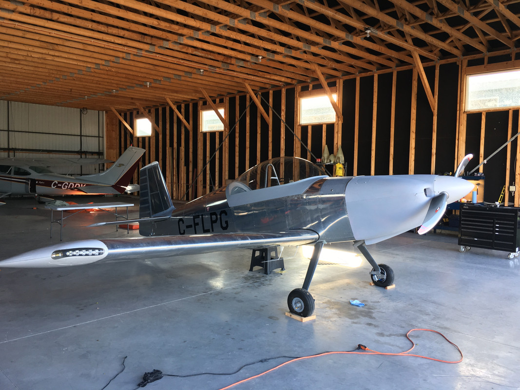

After 8 years and 8 months, it's officially an airplane!!

Great work Andrew! That?s how long it took me to build. I have over 90 hours now in my 8....just an awesome machine!
Are you doing the first flight?

Thanks Don, Yes, I'll be doing the first flight. I've flown with Mike Seager for about 12 hours and flew a friends RV6 recently for a bunch of circuits.
Pretty excited, just waiting on weather.

They look amazing on the ground. will probably need to redo part of the brackets to get the landing light at a better angle for night work. That's down the road though.
