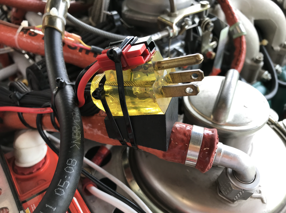

My battery suddenly stopped charging, and my mechanic has done everything suggested in this RV-12 Forum and elsewhere for this malady, including replacing the rectifier/regulator, grounding the regulator with a wire (in addition to cleaning the contact the regulator housing makes with the firewall), testing the stator, checking and reattaching the wires leading to and from the regulator. None of those things fixed the problem. I'm still getting amp readings between -4 amps and -10 amps (depending on which equipment is turned on), even when taxiing at 2500 and higher rpms. The battery voltage also drops, and is now down at the low end of 11 volts.
I'm beginning to suspect my system has a parasitic drain in it somewhere.
Finally, my question:
I have pigtail wires attached to the battery (about 6 inches long) so I can charge the battery through the oil inspection door without having to remove the cowl. The charger attaches to the wires via a plastic PowerPole connector that, when not in use, is protected by a cap. The cap is tight, so I've jiggled it and the wires a fair amount every time I use the pigtail wires. (I use them whenever I turn on the Dynon displays while the engine is off, for example to update databases and learn new-to-me Dynon features.)
Is it possible that the pigtail wires themselves are a parasitic draw on the battery, as a result of damage I did while jiggling the cap?

I wasn't aware that Anderson Powerpole offered a protective cover. This presents no problem.
I made an Anderson Powerpole pigtail for my battery and connect an Odyssey OBC-6A charger 24/7 when airplane is in the hanger. The Odyssey charger is not a trickle or float charger - it charges only when required - otherwise it sits idle. Main reason I use it is that it has a de-sulfate cycle each time it's powered up. I've been doing this for three years and battery is hunky-dory.
How old is your battery?
What battery charger are you using?
