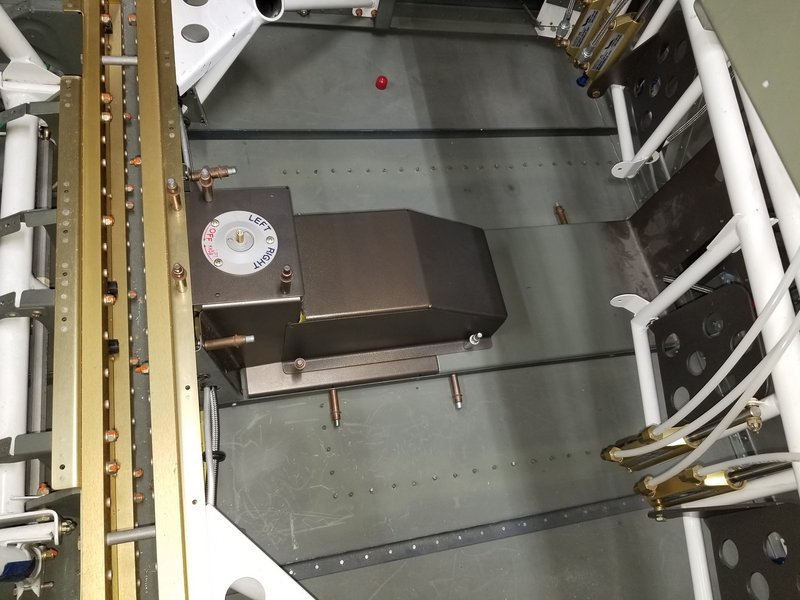

Fuel pump and powder coated cover.

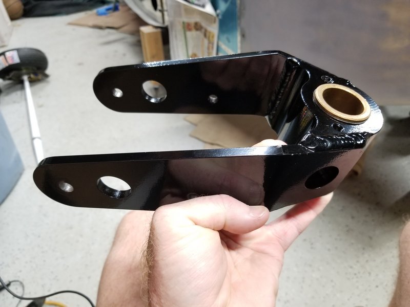

Having too much fun powder coating things. I took my baffles elsewhere since they wouldn't fit in my little oven. Now the wheels will go on. I could wait, but I'm excited to do it and I can work on the wheel pants etc while I figure out how I'm paying for my panel.

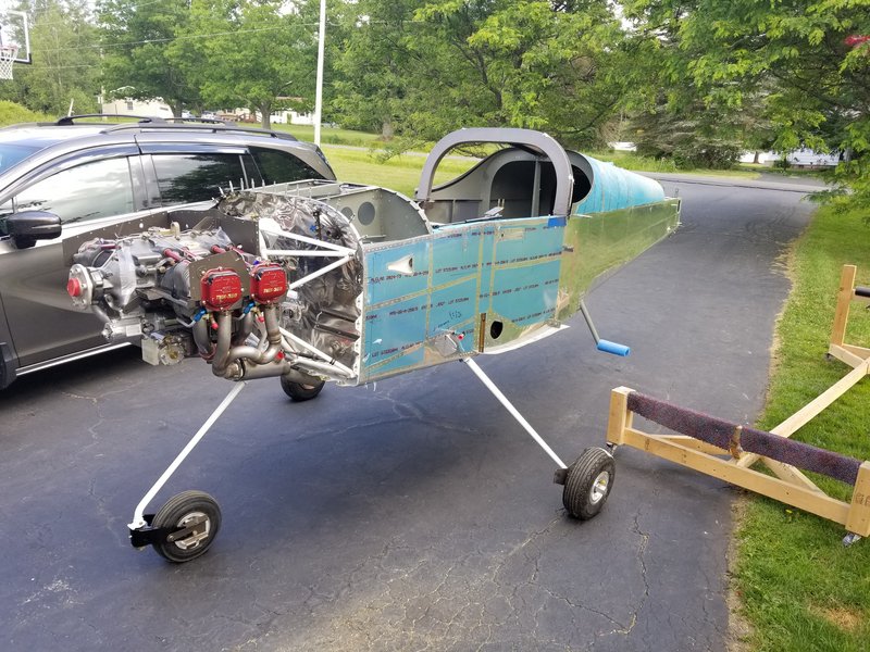

Gear installed today!! Woohoo!!!
I think DIY powder-coating is cool, but I will offer one comment regarding something that a lot of people don't know about.
Highly loaded parts like a nose gear fork (engine mount, landing gear leg mounts, etc.) sometimes crack. Looking for cracks on these types of assemblies is one of the things done during a condition inspection.
Painting or powder coating these types of part with a dark color (black being the worst), makes cracks nearly invisible.
That is why all parts supplied pre-powder-coated in the kits have always been very light grey or white.

Well guess I made a rookie decision on the black powder! If i knew that a few days ago I would have picked a different color. Thanks for the info!
