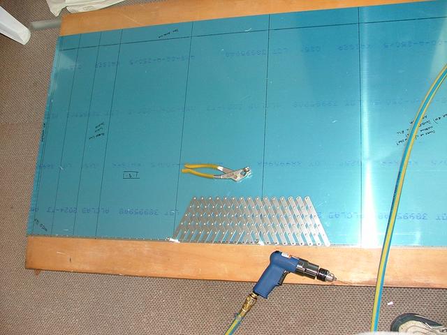

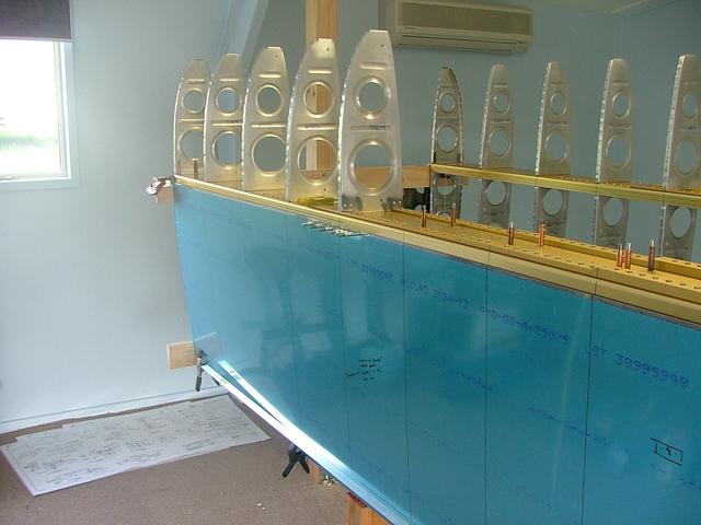

From memory when I did mine I predrilled only the main spar holes in the skin then made doubly sure everything was in place and square etc, then I drilled all the spar starting in the centre and working outboard and inboard spanwise. The skin was then "hanging" from the spar, I worked my way down and across from the middle out drilling the skin and ribs together to finish at the rear spar. I am sure there is more than one way to skin a RV 3 wing and this is just how I did mine.
