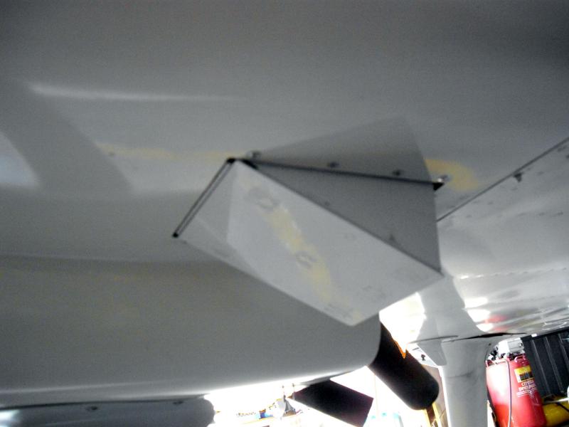

Default cowl flaps position for cutting
Hello,
I am going to install my cowl flaps and I don't know exactly where to cut my cowl. There is no indication on the A.S.A sheet. I read somewhere 3 inches from the rear of the cowl.
Is somebody to help me ?
In advance thank you
Sylvain

Originally Posted by Sylvainsting View Post
Hello,
Sylvain
Here are a few photos that will help clarify the location for your Easy Cool
flaps. If you can give me a call I am certain I can save you a lot of time
and work on your installation. Thanks, Allan...
