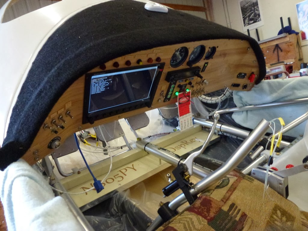

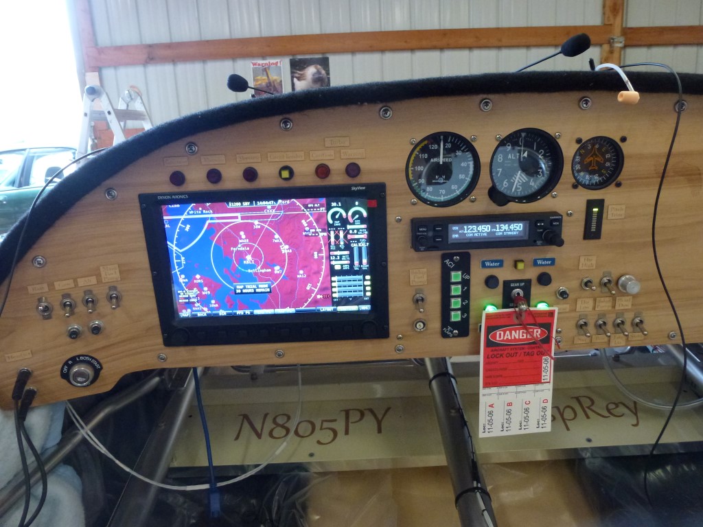

The panel will be mounted overhead, and I'm actually on the second iteration. The first one was made out of fiberglass layup, and I messed up and put the compass right next to the radio. (oopsss...) Around that time a gent stopped by who had done avionics work in the USN for 23 years and started pointing out small things that could be improved on, soooo....... We're redoing the whole shebang, making it better, stronger, and faster for repairing.

In the case of the SeaRey, it's attached to and hangs from the nosedeck. The way we do it, however, is being changed in the MkII panel we're now building.
