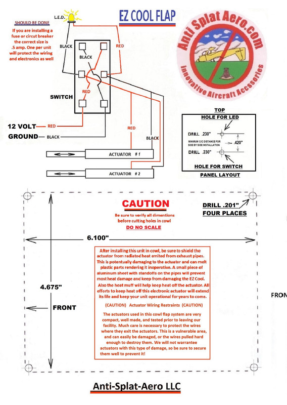

I plan to install two cowl flaps ASA in my RV7 finished from 3 years, and I would like to connect them with my VPX sport but I only have one port available. So is it possible or not ?
in advance thank you for your reply

I would contact Allan with that question, but you should be fine. I?m not using a VPX but both of my cowl flaps will operated via the same circuit and controlled with one toggle switch.

Both of mine are connected to one port of my VPX-Pro, works fine.

?.Here is a diagram for wiring them up. You need a DPDT switch, and yes
you can wire them together. They only pull 200 m-amp each. Thanks, Allan

Hello Brantel,
Did you connect your cowl flaps on a specific port or a normal port ?
Chad from Vertical Power just said me it is impossible to connect cowl flap on a VPX because there is only one specific port for the Flaps but nothing for another device.
Or perhaps the VPX Pro is different than the VPX sport ?

I?m sure Chad is referring to the regular flaps...not ?cowl flaps?. If he said that there?s only one port for them, I?m sure he just misunderstood you. I had the VPX on my other airplane and I remember there being one specific pin to connect them to to operate the flaps.
