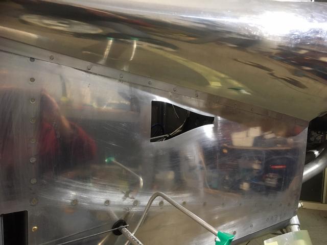

I did the same searching for air vent info and came to the same conclusions, I purchased the RV 10 vents but decided I didn't like the trap door type operation (no doubt they work well though) so I went with kit supplied NACA vent and put it just below the RH cheek extension with an eyeball vent under the panel. I would preferred in the panel but have no space left there...The small cable in the bracket operates the cabin heat box and is not part of the vent. The "in cheek" installs look very slick and I considered doing that but found that when the cheek extensions were fitted and drilled they are under a certain amount of spring back tension and I wasn't sure how cutting a hole for the vent would go. Guess I could have made glass extensions and they probably would have fitted a whole lot better but I like aluminum. Anyway it's not flying yet so I don't know how effective this setup will be but I think you could fit one into a flying plane without too much trouble.
