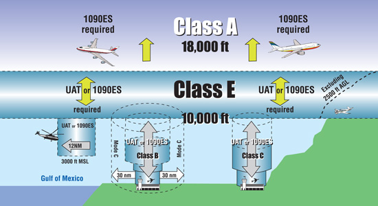

Don't forget ADSB out is not required in a huge amount of airspace. If you do not require Mode C, you do not need ADSB out even next year is pretty close.

As mentioned above, much depends on your location and your mission. I personally don’t plan to install it right away. I fly in required airspace for my day job and don’t need do it in my spare time. Again, much of the continental US airspace is outside ADSB required use.
