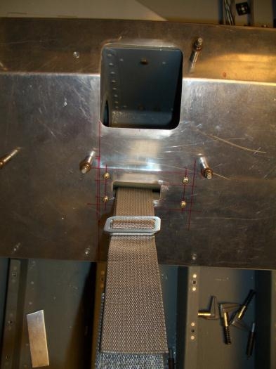

Sooooo........I read the article in EAA magazine about Simpson harnesses and was wondering if anyone has mounted it in a 6 or 6A and what it entailed? Which version did you use? I like the idea of a crotch strap to keep the harness from riding up.

How did you secure the centerstrap? Pics would be awesome!

I used the VANs 5th point kit for the RV-7, but cut off one side of the brackets and replaced it with a piece of angle so I could adjust the width. I also replaced all the belt ends from crow with standard triangular ends since they are shorter.
Nicely done!!
