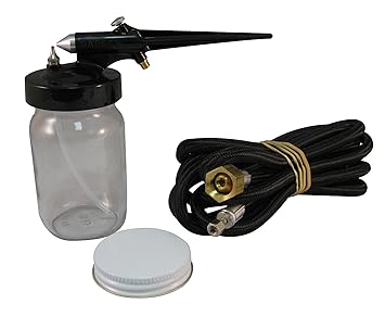

Since the Akzo has an easy 1:1 mixing ratio I found that small jobs can be handled with the 1 oz jar in a cheap Badger air brush. It's also easy to clean.
For slightly bigger small jobs a 2 oz jar is also available.
