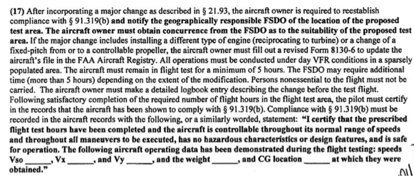

Yes, You DO re-enter Phase I for testing a new prop. The sign-off after the testing is the same as when you completed your original phase I.
Operating Limitations are pretty clear on this.

It does NOT contradict! Phase I is NOT, and has never been signed off by the FAA or a DAR
14. After incorporating a major change as described in § 21.93, the aircraft owner is required to reestablish compliance with § 91.319(b) ...............Compliance with § 91.319(b) must be recorded in the maintenance records with the following, or a similarly worded statement: “I certify that the prescribed flight test hours have been completed and the aircraft is controllable throughout its normal range of speeds and throughout all maneuvers to be executed, has no hazardous characteristics or design features, and is safe for operation.” (23)
Compliance with §91.319(b) IS Phase I.

Originally Posted by Hartstoc View Post
Ed- I don?t believe you are re-entering phase 1 testing.
I just converted from fixed to constant speed a few months ago and it is very clear in the operating limitations that the aircraft will go back into Phase I testing for a minimum of 5 hours. The FAA has to approve/conquer with the flight test area and assign the flight test time required.
It is at the discretion of the FSDO (per the ops limitations) if they require more. I was asked to do 40 hrs of additional testing originally and I was able to talk with the POC down to 5.
Axel

Mel- thanks for the clarification! Good to know I have not been flying in violation!- Otis
