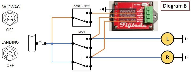

Ross - I think what would help most would be some (partial) circuit diagrams showing options or suggestions for wiring the various switches & breakers to the unit.
Here's a great example from https://flyleds.com/products/#!/WigW...155/category=0
This is one of several options depicted on that page.
More examples here: https://flyleds.com/info/
Thanks, and looking forward to getting my CPI2 soon!

Agreed. Something like this would makes things more clear. Thanks.
We'll try to work something like this into the manual over the next week.
