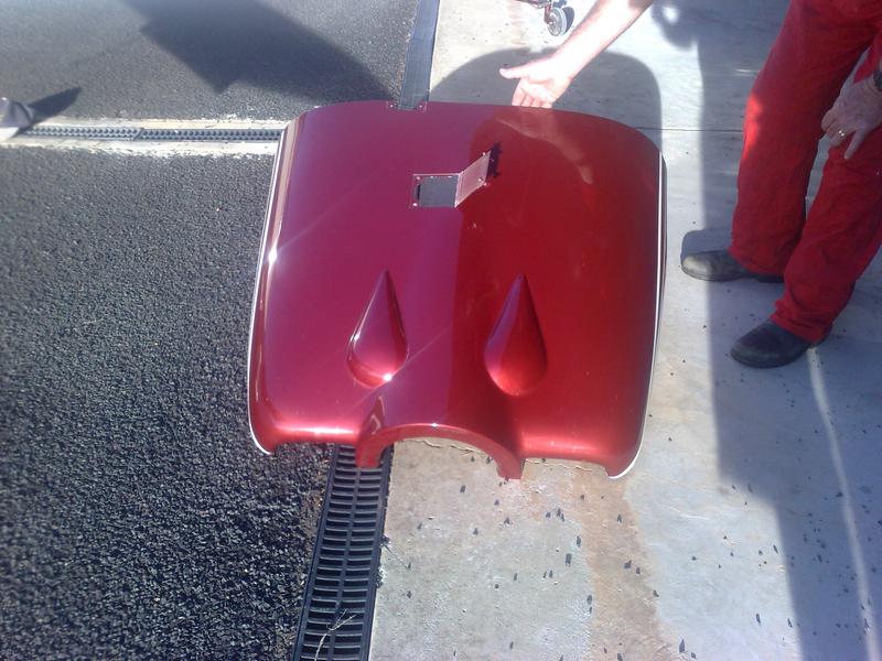

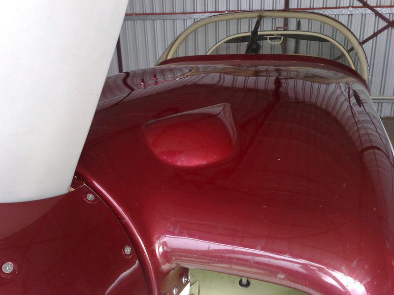

2) I read that the mechanical fuel pump will require a bump on the cowling, does anyone have a picture to get an idea of it?

I have seen one -6A with this engine and the guy added a matching streamlined blister on the other side to make it look balanced. The blisters we're not that big and didn't look bad.

my 6 has this engine w no problems,have 2 matching bumps on cowl looks good,did use tbo engine for phase one then switched to rebuid later as previous mentioned,i believe there is a h2ad exhaust for rv on the bay for sale,can send pics of cowling if needed

Forward engine driven fuel pump (a standard RV6 cowl will just clear without mod)
I would really appreciete a couple of pictures to better understand how you did the cowling.
I am not Block but here is a couple of pics of how I did the 'bumps"on my early RV6 cowl for the H2AD. My cowl needed bumps on both sides. One side for the fuel pump and the other for the prop governor housing on the front right of the crankcase. The RV9 cowl may be a little different.
The baffles for this engine are also different from the standard 0320. I have some pics of them also if you need them.
