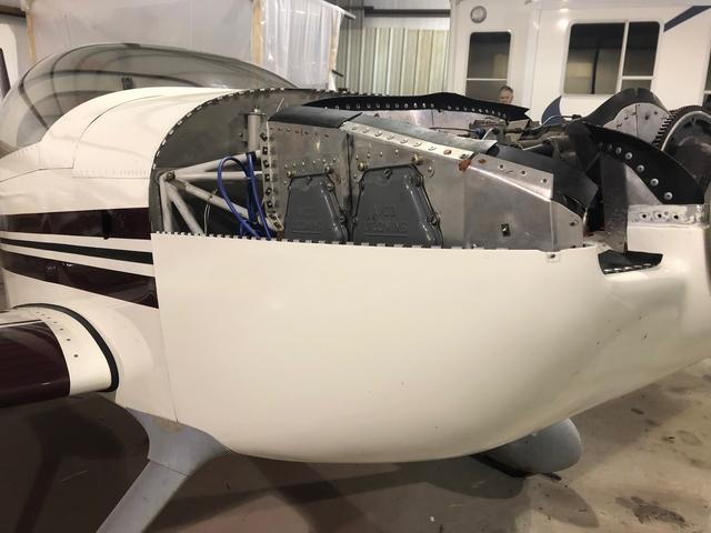

Originally Posted by Gyrodoug View Post
The IO360 is a FAA certified motor at 200hp. Does this help clarify?
Thank you.
As soon as a "certified" engine is mounted on an experimental aircraft, the engine comes "experimental" as well.
A minor but important point, if the engine is ever to go back on a "certified" airframe. This typically means a complete overhaul to TC configuration.
One last thing, and I have to add this because I always catch it with my engine and airframe combination, Van's does not recommend the angle valve IO-360 for the RV-6(A) or the RV-4 for that matter.

You might run some W&B calculations before pulling the trigger.

Alan Judy has an RV6 with SJ cowl and angle valve. Tight, but fit.
Check Vne?
Folks,
Can anyone talk about any concerns, issues, worries, whatever, regarding swapping an O360 180hp already on the a/c with an IO360 200hp....
All input is welcome. Thank you!!!
Issues with doing it to a 6 have already been posted, HOWEVER you said a 6A and there is an item to address.
Vans specifies a maximum weight limit for the nose gear. On my 7A with a lighter engine than you propose, I am close but within limit in all W&B scenarios.
I recommend obtaining that specification from Vans for the RV6A, redo the W&B based on your own scale measurements, make an estimate of new W&B with new engine, calculate nose gear load and then make your decision.
If you are new to RV's, search here for nose gear failures to aid in a decision to go outside recommended loading.
