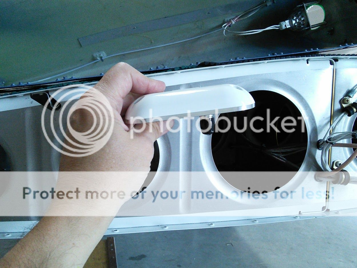

Default antenna mount
I received a Lynx transponder yesterday and thinking about the install. what about mounting on a plastic printed bracket at the wingtip. any problems with that approach?

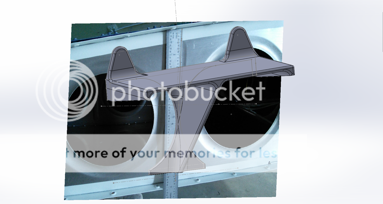

Default antenna bracket
maybe something like this?
