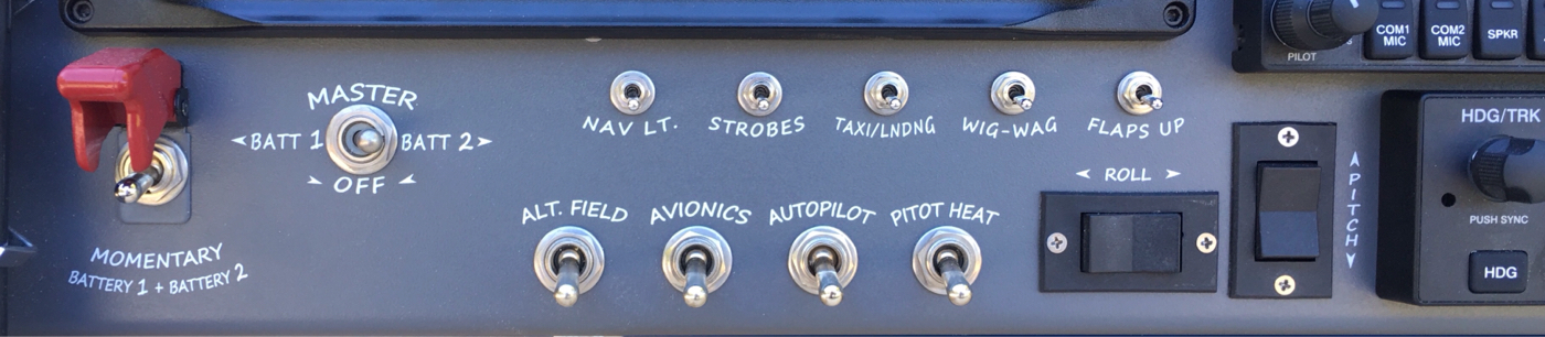

At the top, two panel-mounted switches are depicted. The lower one, a DPDT On-Off-On mil-spec MASTER, mounted horizontally as shown in the pic below, is the most important. Shown here in the off position, it is wired such that if moved to the left, it energizes the contactor for Battery1 via one pole, and ALSO energizes the mini-relay for Battery2, allowing it to be charged via a Schottky diode via the second pole. In this mode, Battery1 is serving as primary, and Battery2 is serving as backup that can only be discharged by active loads on its ELB. Flipping the Master instead to the right reverses the roles of the two batteries. It ABSOLUTELY DOES NOT MATTER which direction you flip the Master switch for a given flight, and SOP will be to alternate randomly from flight to flight for a reason described below. Note that this feature alone meets ALL FIVE of the criteria listed above!

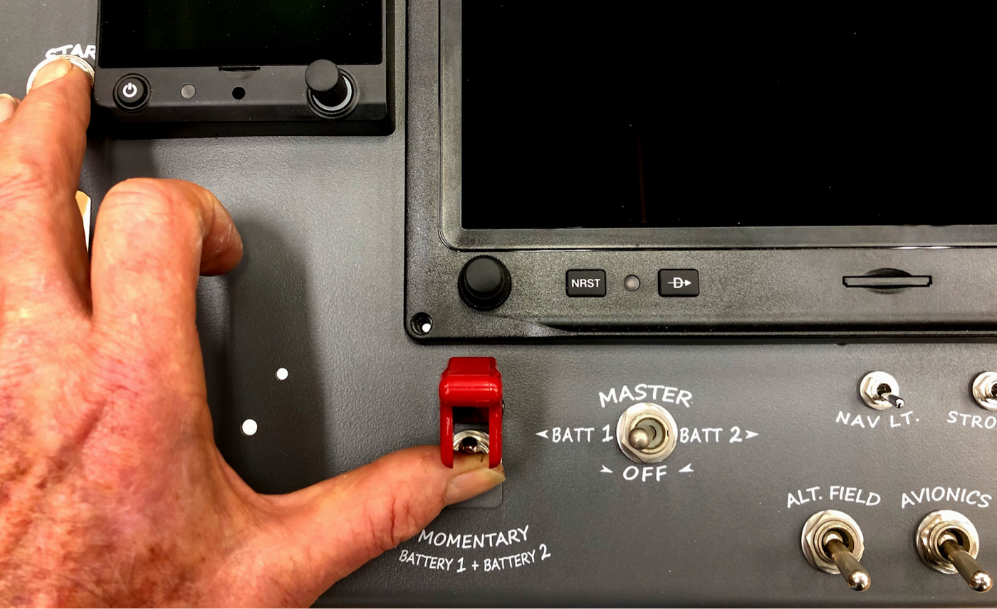

The the other switch, shown below, is unique. It is a guarded, spring-loaded to Off, DPST momentary. If you flip the guard up and manually engage the switch against the spring-load, it energizes BOTH battery contactors momentarily. This serves two purposes. First, it is physically positioned in relation to the start button such that the left thumb can engage the momentary while another finger on the left hand simultaneously pushes the button, allowing the mighty force of both batteries together to spin the starter.
Second, the momentary can be engaged in-flight using the forefinger of the right hand, while the thumb of the right hand flips the master to the opposite “ON” position. This maintains power to all main bus loads during the switching of battery roles in flight. Why would you want to do that? Even at low-amperage charge levels, the Schottky diode charging the secondary battery robs about 1/4 to 1/3 Volt. LiFePo batteries are sensitive to charge voltage, and may not quite fully charge at this slightly reduced voltage, so switching the battery’s roles mid-way through a long flight would allow “topping off” of the battery that served as secondary during the first half of the flight. This is also the reason for routinely alternating the master switch selection from flight to flight.

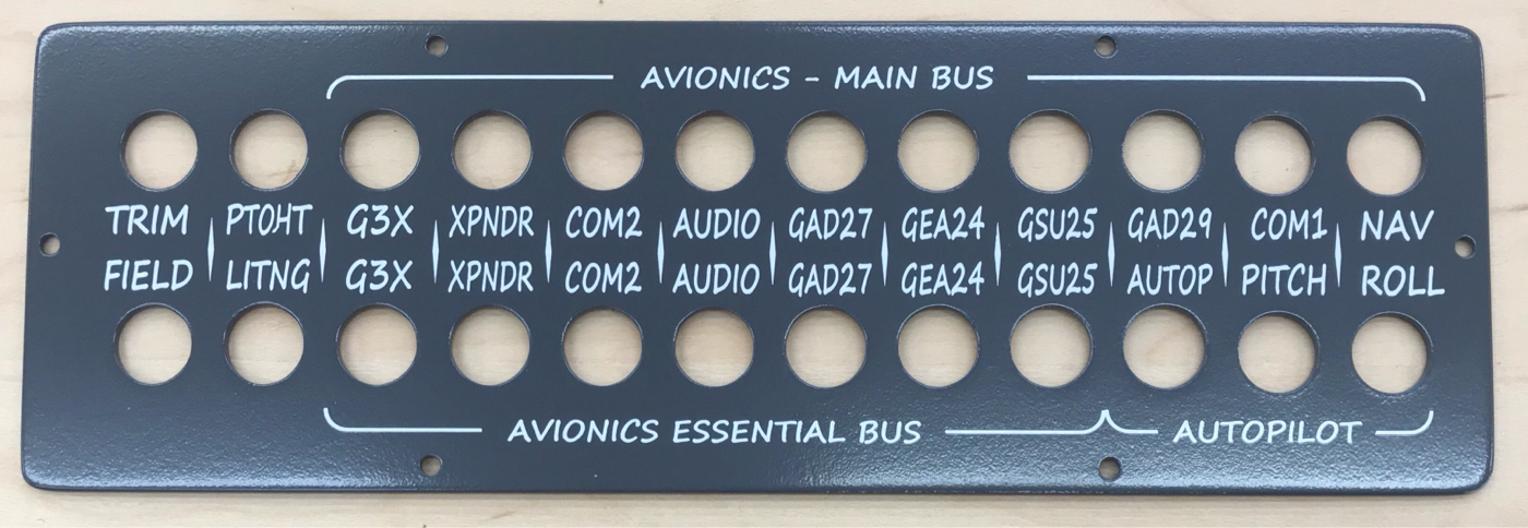

Take another look at the lower section of the diagram. In addition to two micro-switches that energize the V/A meters, five mil-spec On-Off-On switches, installed horizontally in a vertical row access either ELB. Only the bottom four are true essential loads, the two ignitions and the twos fuel pumps. As with the Master Switch, it ABSOLUTELY DOES NOT MATTER which direction these ELB switches are engaged(though in practice the only load I’ll run full-time on the “backup” battery is one lightspeed ignition. in one direction they tap the battery that is currently serving as primary, and in the other direction they tap the battery serving as backup which, remember, is kept charged through the Schottky diode. The top switch, labeled “Aux. Avionics” is not, strictly speaking, an essential load. Instead, it enables power to be sent directly from either battery to the group of seven CB’s at the bottom of the CB block pictured below:
The Garmin LRU’s fed by these breakers have two power input pins each, P1 and P2. Each device draws power from P1, which is connected to the main bus via the top row of CB’s, but if for any reason P1 power is lost, it looks to P2. In effect, switching Aux. Avionics on does not actually result in any current flow unless the main bus gets shut down. This means that a selection of avionics remains available from battery power if the master has to be shut down, but also allows pre-start use of avionics on battery power without energizing the main bus, handy for flight planning. The three CB’s not included in the lower group are for the GTN750 and the GAD29. Conserving power after an alternator failure can be accomplished by selectively pulling some of the lower avionics CB’s.
This photo shows the other panel mounted switches that feed the CB block. The micro switches in the top row are no-load communicators to the GAD27.

Where are the essential avionics; are there duplicates on each bus? If the avionics are on the 'aux avionics' switch....
Oh, edit: Fail the 'milspec' master switch. What happens?
edit2: From the drawing and accompanying text, it looks like start current will be on your main bus (?).
