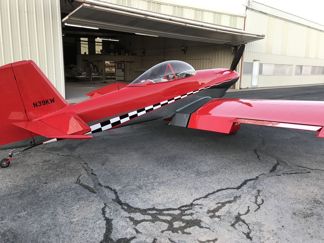

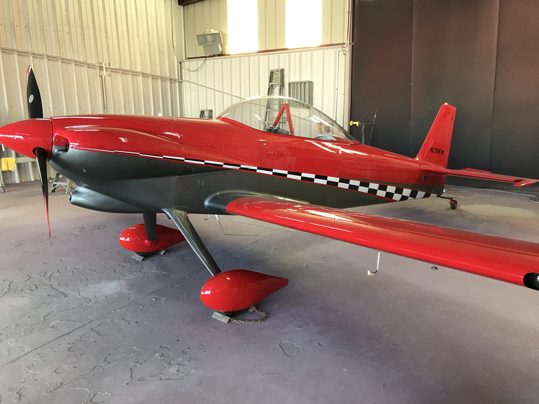

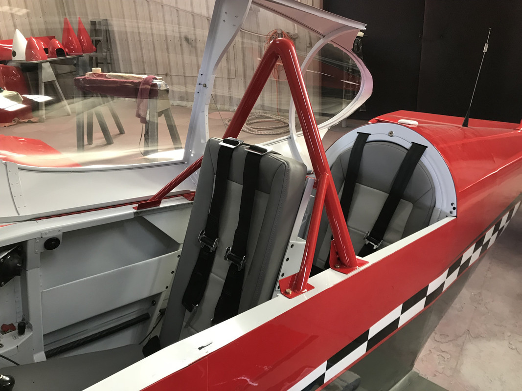

Purchased a flying aircraft built in 2000. Low time, High quality build and well equipped with tall gear, O360, CS prop, etc. Exterior was John Deere green and interior was cheddar yellow. I spent the first 6 months of ownership doing a complete strip and repaint taking care of any needed maintenance along the way as aircraft was disassembled. Flying the aircraft now and having a blast with it! Previously owned a C-140 and a Citabria 7eca. Both great aircraft, but the RV is definitely another level of fun!

Here is a link to photo gallery containing pictures of the restoration if anyone is interested. It's a good look into the strip and repaint process start to finish.

1) What did you come across that needed fixing?
2) Is yours a short gear RV-4 I am having a hard time telling. I used to get to fly a short gear 360 powered 4 previously and was not a fan of the short gear with the long prop. It was safe, just a consideration that always was on my mind anyway.
3) How may hours did you put into her for paint?
4) What's the weight difference (did you save any??)

1) Pulled tanks to fix small leaks, install new senders and safety wire fuel pick-up tubes per SB. Rebuilt brakes, installed new tail wheel(had the old non swiveling) Took care of any SB's that weren't complied with and did a thorough conditional inspection.
2)Tall gear-with HD weldments/gussets were a must for me.
3)Didn't keep track of hours. Six months of spare time. Pulling and refinishing the interior drastically increased time spent.
4) Weight was a wash-1070lbs. empty
