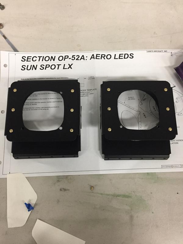

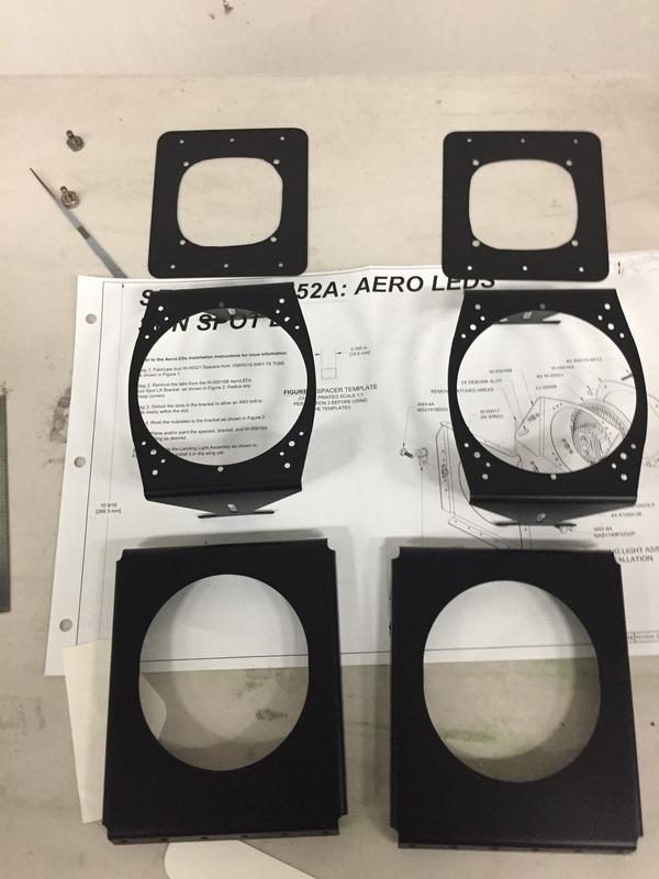

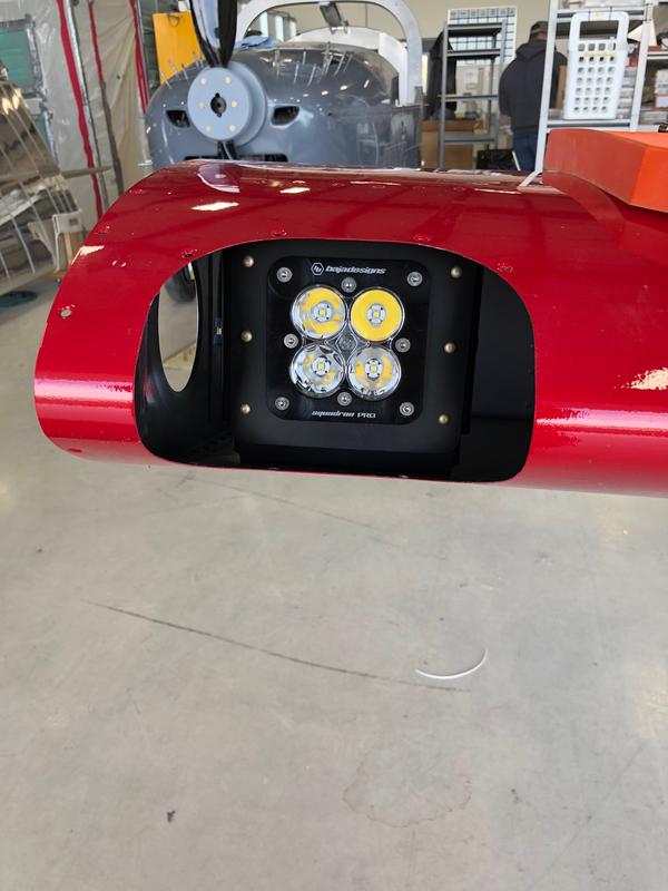

...plans section OP-52A and associated parts? I used the brackets and hardware to install Baja Designs Squadron Pro lights. I had to fab a plate to attach the lights to (plate at top of first picture) and rivet it to the mounting bracket (middle bracket in the first picture).
It doesn?t matter that you have installed the bracket in the wing.
Here is the plate riveted to the bracket:
Light installed:
You can order the entire Sunspot LED kit from Van?s and delete the lights or install the Sunspot lights.
