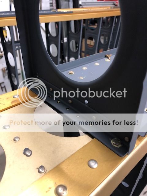

Hi guys first post to VAF.
Iv started on building some sports wings for the rocket. I optioned for the 55gal fuel tank option from Harmon. I received everything last week with hr2 plans.
I?m just looking for information on the 55gal. Has anybody done this on there own wings. Harmon only supply plans for 42gal tanks. I mainly just would like to know leading edge rib spacing on the tank and oble area as there are lighting holes in the main spar right where I need to put my w-408 rib.
Any information would be muchly appreciated.

The tank construction is same as 42 gal. except will require more ribs and additional plate riveted to spar which is about 12 inches, the lightening hole is not a factor use angle support on rib to attach w 408 to spar . Order additional ribs , #8 screws and nut plates along with more pro seal . Use 42 gal rib spacing as guide you probably will have a closer spacing , use skin supplied as guide for placing w-408 rib. Good decision for large tanks, the ones I?ve built will typically hold just a little over 56gal.

Wings are coming along nicely this is how i decided to attach 408 rib over the lighting hole. angle on both sided of the spar web and a 40th spacer in between. all cherry max together
