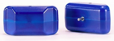

You guessed it? new member here. Yesterday I flew with my friend in his 1-year old RV-12 S-LSA with 130TT. I smelled a whiff of gasoline on take-off and on initial climb. We flew 30 miles and landed/relaunched again with same smell of gasoline. Flew another 30 miles and landed and this time shut off the engine. On engine restart we had extreme roughness and zero power. Upon exiting the aircraft there was a puddle of fuel on the ground. We removed the top cowling and ran the electric fuel pump to discover fuel pouring out of the right carb air filter.
The airplane had to spend the night and we got a long car ride home from a friend. This morning we gather tools and a spare set of Bing floats and set out to bring the plane home. We removed the floats from the offending carb and weighed them on the spot at 8.83 grams. The spare floats I had are actually
?heavy? floats sent to me by Paul Straub. I was going to experiment and try to lighten the floats but never got around to it. Anyway, I measured the floats this morning and they were 6.3 grams. They must have dried out over time. We used these floats to fly home and will replace soonest. I suspect floats that once absorb fuel will do so again ? probably in short order.
So, a few observations?
1. Floats weighing 8.83 grams will sink to the point of allowing raw gasoline to flow out the inlet of the carb and drip from the air filter.
2. If you smell fuel on take-off or initial climb you probably have heavy floats and a fuel leakage is occurring.
3. On closer examination we see the discharge end of the clear overflow tube that tucks into the float bowl bail wire has a deformed end. Instead of a clean flush cut, the end almost looks melted. Perhaps fuel was leaking over-time and distorted the end of the tube?
4. We will add a set of dried-out floats to the list of spare parts carried in the airplane.
Now for the hundred?s-of-dollar?s question?
Do we buy Bing or Marvel-Schebler floats? I?m leaning toward Marvel-Schebler. Perhaps a show of hands from the guys using MS floats and what their experience has been so far. The detractor I have with MS is they don?t answer emails and that just leaves a real sour taste in my mouth.

  #98
Old 04-07-2019, 05:55 PM
pilotyoung pilotyoung is offline
Join Date: Jan 2018
Location: Birmingham, AL
Posts: 207
Default Floats
I talked with the MS guy at Sun 'N Fun about the floats. He said they are out of stock right now so they took them off their web site. When they get them back in stock, they will be back on the web site.
He said these floats are made of the same material and in the same manner as the floats they make for certified engines. He also said in their testing, the fact that they weight more than the bing floats does not matter.
I don't have to buy any right now, but when I do, I will consider MS floats.
A very experienced Rotax mechanic told me if you have to replace the floats, save the ones that are under the weight limit because you may need them in the future. Like you suggested, carry them in the airplane.

Default Thinking Outside the Box?
The Marvel Schebler floats apparently are heavier than the 7 gram Rotax spec and will most likely cause fuel level to be high in the float bowl.
I have an idea to fix this. Marvel Schebler says their epoxy floats can be cut and punctured and still function as designed with no fuel saturation into the base epoxy material.
Bing designed the float to be symmetrical so that it can be installed without regard to orientation.
My idea is to remove some of the base material on the MS float to attain <7 gram weight. Either machine off some of the top of the float to reduce height and/or machine chamfered edges on the top side of the float. Either method will reduce weight, and if as MS says, the epoxy will remain sealed to fuel impregnation. With this modification the float will no longer be symmetrical and will require correct orientation during assembly.
I have sent this suggestion to Marvel Schebler and we?ll see if they respond. In the mean time, I?d like to get hold of a pair of MS floats and experiment with material removal to get weight under control.
Below are pics of original MS floats and floats modified for height/weight.
