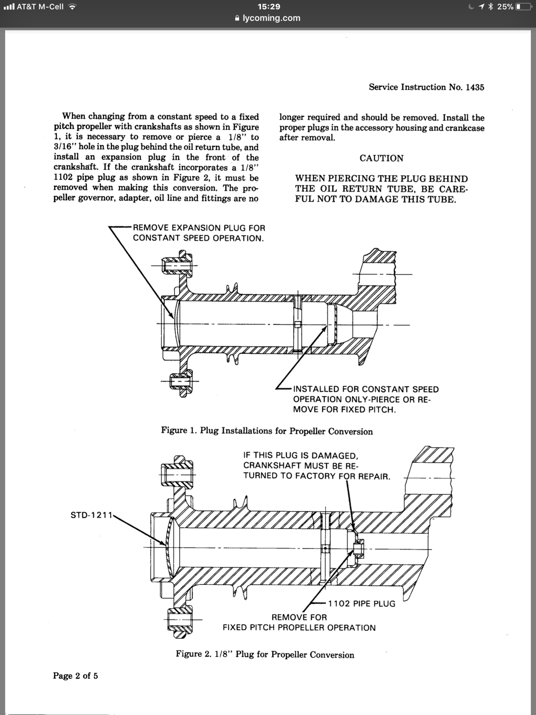

You need to find someone with the special tool who knows what they are doing to remove the rear prop shaft oil plug (the one with a hole) and replace it with one without hole.
If you have never seen this done or do not have the special tool, do not attempt doing the job as you can easily damage the internal oil tube.

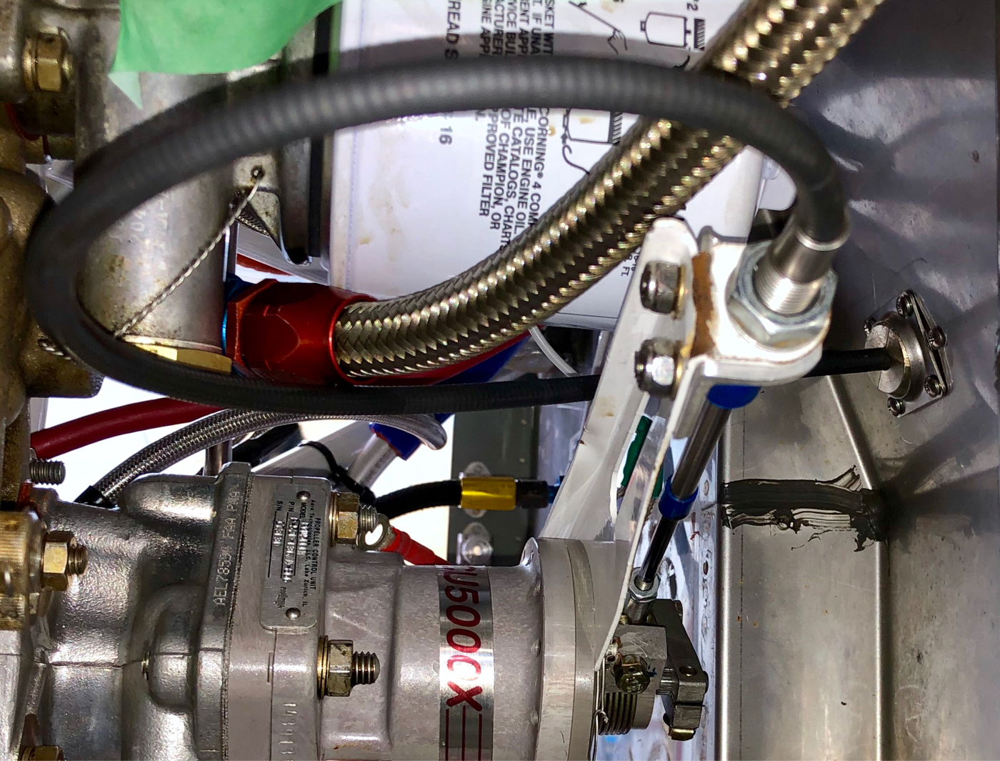

Ed-which governor are you using? If the PCU5000, I have some suggestions for the cable installation. One involves reversing and reinforcing the bend at the cable support end of the Van’s install bracket, resulting in a much more elegant and smooth-operating cable routing. Will take some photos next time I’m at airport.
Also, I got the smoothest operation by penetrating the cable through the firewall fairly high up, level with the top of the governor, and letting it do a gentle, full 270° loop to the left forward of the firewall to lend up pointing straight at the actuator arm on the governor. An S-series stainless steel split-eyeball from Aircraft Spruce worked very well for firewall penetration. I believe I used one with .25” I.D., but they are available for any cable diameter. -Otis
I did find this photo. Note reverse bending of bracket provided much better alignment of cable to gov. Arm. Concerned about it cracking, I added aluminum angle brace. Works very smoothly and allows full stop to stop travel of governor arm:
Carl
I believe that some, maybe all, rear plugs with holes have the hole threaded so you can simply screw in a plug. (Some that have been converted TO fixed pitch may have a pierced rear plug and would require removal and replacemend). Mine had no rear plug at all so I inserted a new solid one. Btw- this is not an expansion plug like the one Ed will be removing at the front of the crankshaft. It is an interference fit plug with a wide flange that goes in with the flange facing toward the front of the engine. See P.2 below.
- Otis

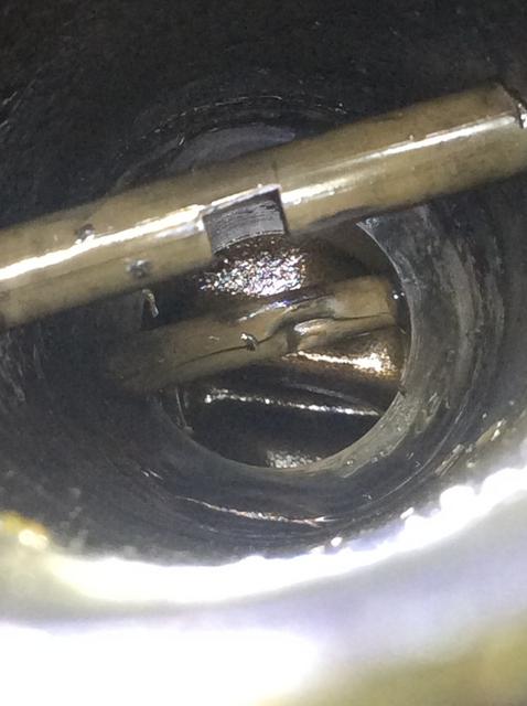

Carl
Take this advice. Here is what i found on my crankshat after pulling the front plug out. Some idiot took the rear plug out with a screwdriver and damaged the rod bearing oil tube. It is by the grace of God that this engine did not seize the #1 rod over the years. The entire rebuild of the engine has cost me $19k.

Originally Posted by Hartstoc View Post
Ed-which governor are you using? If the PCU5000, I have some suggestions for the cable installation. One involves reversing and reinforcing the bend at the cable support end of the Van?s install bracket, resulting in a much more elegant and smooth-operating cable routing. Will take some photos next time I?m at airport.
Also, I got the smoothest operation by penetrating the cable through the firewall fairly high up, level with the top of the governor, and letting it do a gentle, full 270? loop to the left forward of the firewall to lend up pointing straight at the actuator arm on the governor. An S-series stainless steel split-eyeball from Aircraft Spruce worked very well for firewall penetration. I believe I used one with .25? I.D., but they are available for any cable diameter. -Otis
This is exactly what I did when installing a new Hartzell Gov and it improved the cable movement immensely. Highly recommend following Hartstoc's advice
