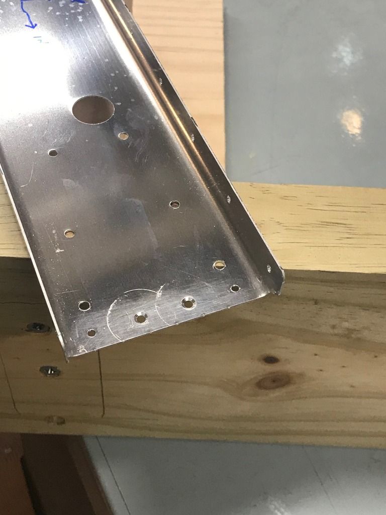

Guys,
I am working on -8 empanage / elevator.

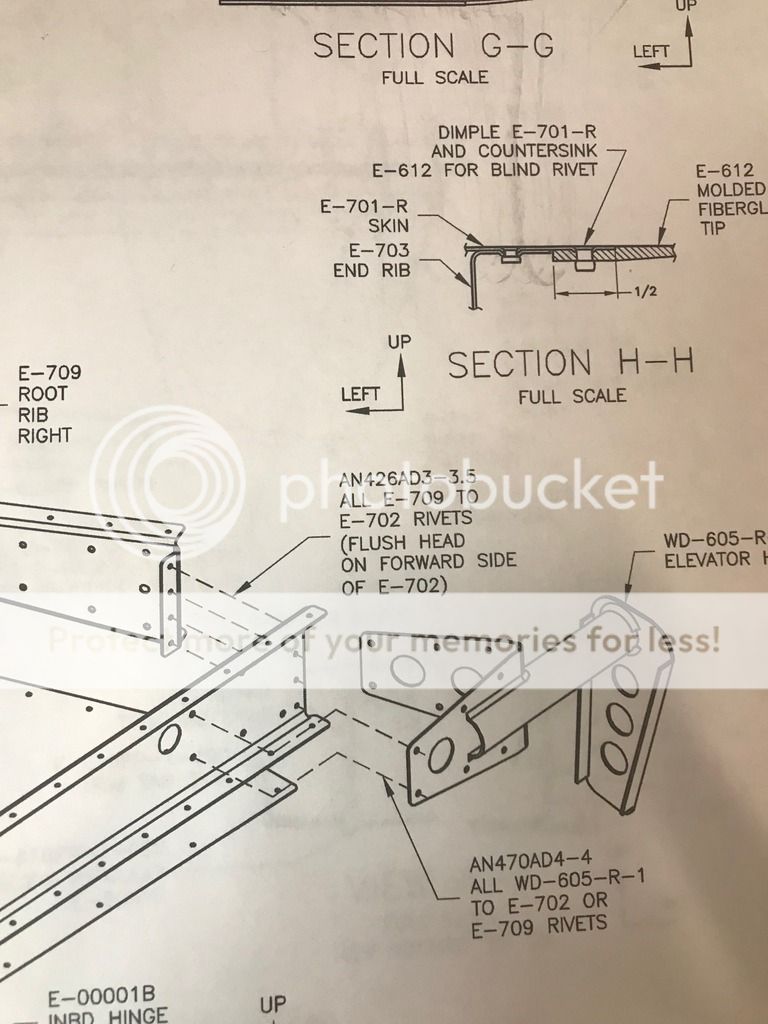

I am to the point of countersinking the spar in 4x to attach the E-709 rib.
Call out requires countersinking as elevator horn fits over spar and must sit flush.
The two inside holes - easy.
What's up with the outside / upper and lower holes?
Do I take a cut off wheel to my micro countersink cage?
Help!
Ken Owen

Yep - Just grind the side off the bottom of the cage - Just enough so it fits.

Instead of cutter mod all I did was chuck the bit in a drill or in my deburring tool. Works fine - Do it carefully and check depth with a rivet as you go. At times I got to lazy to get out the countersink and did it this way even when there was no access problem.

I took the CS bit out of the cage and did it freehand. Easy Peasy. Just take your time. I have a threaded mandreal from an old CS cage that was pretty beat up. I threaded the bit into that mandrel which I then chucked up in my drill.

I suggest you buy two more microstops; one for #30, one for #40, and one for everything else. I wasted so much time adjusting that thing every time I switched bits it drove me crazy!

Can you dimple instead of machine countersinking?

I couldn?t see any reason not to dimple those. So I did.
Lots of others here dimpled those as well.

This is a case in example where you are over thinking this. I remember this. In situations like this, ALWAYS recall the option to simply grab your hand debur tool, change out its debur bit with the #40 or #30 countersink (whichever matches the hole) toolling bit, then hand countersink using finesse and care. And move on.
Obviously return the deburr tooling bit back into your hand deburr tool.
Yes, you can dimple these here. That advice applies. It's just overkill. But yes, dimpling is always better. Just not needed in this instance.
