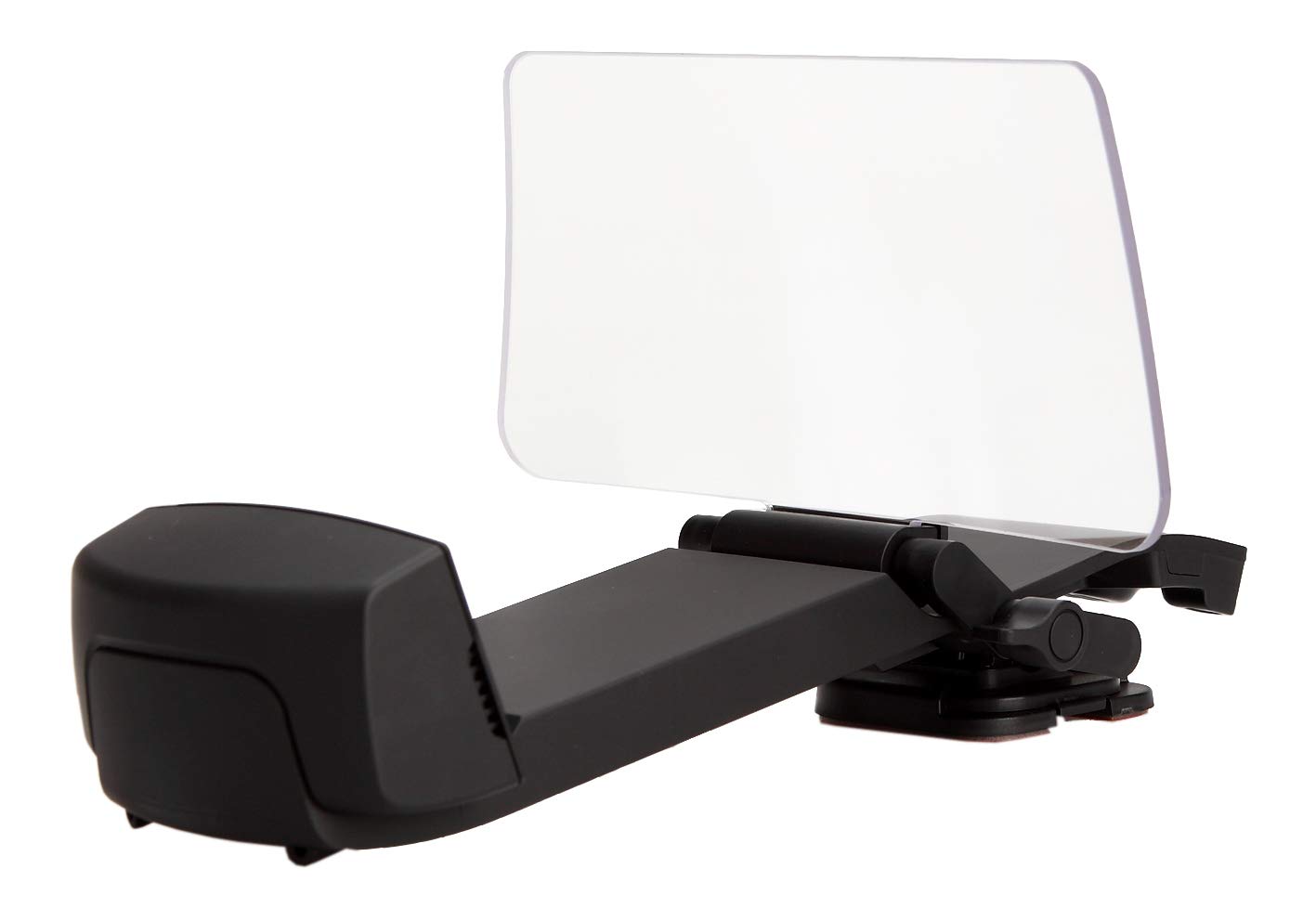

As far as I can tell the unsolved problem is a HUD display focused at infinity that does not requires a massive disruption of the instrument panel/glare shield, and which is visible at all Sun angles.
Hudly is a step in the right direction but it's only focused a few feet from the prop and I think I read somewhere that it's not always easily seen at certain Sun angles..
Originally Posted by 622BH View Post
I got excited when the possibility of using glasses for "HUD" was published - quickly that morphed into the current technology.
Originally Posted by jacoby View Post
The focus and visibility issue is real. I don't know all the details but it has been discussed. There doesn't seem to be a practical solution right now. You can choose between the ~$1k hudly or go off into the certified world and spend a magnitude more.
Most that use the auto based HUD displays seem to comment that the focus to infinity problem is true but ends up not being much of an issue. Visibility in some cases can be compromised as well but reports are that this is also mostly a non issue. Heck even the best EFIS screens and definitely Ipad's have visibility issues in some cases so there are trade-offs all around.
I am no optics expert but I do ponder on why it is so hard to make an inexpensive HUD display focus to infinity? Why is that so? One thing I have learned is that VAF usually has a trained expert on just about everything there is. Someone on here knows....
As for glasses, that is still a possibility if we find some with the right capability. Glasses based attitude displays can be disorienting unless we add some sort of head tracking AHRS to the glasses and this gets complicated fast! All the other info could be added though without too much trouble.
I have a Kivic display on the way to test with. I like the Kivic because it seems to have the best all in one footprint and might work better for a tipup canopy. Will report my experiences with it.
I did a bit of research when this was discussed on the email group and it seems most of the issues come from the light source. Apparently it has to be lined up parallel in all directions (like a laser except bigger). So you need one big array of light so there is no disbursement of the rays when they are reflected back from the glass.
I have no clue how the true infinite focus displays manage this or how to get close enough with COTS hardware. Maybe an array of fiber and LEDs?

Interesting, I hadn't heard of the Kivic. Still, this doesn't look like it'll fit "cleanly" on the glareshield like a Hudly would:
Rob Prior

Problem with the Hudly Classic is that it has been discontinued. The Hudly Wireless has issues like tinted glass and it is flat not curved which causes issues.
Tipups also have different challenges vs sliders or the RV10.
