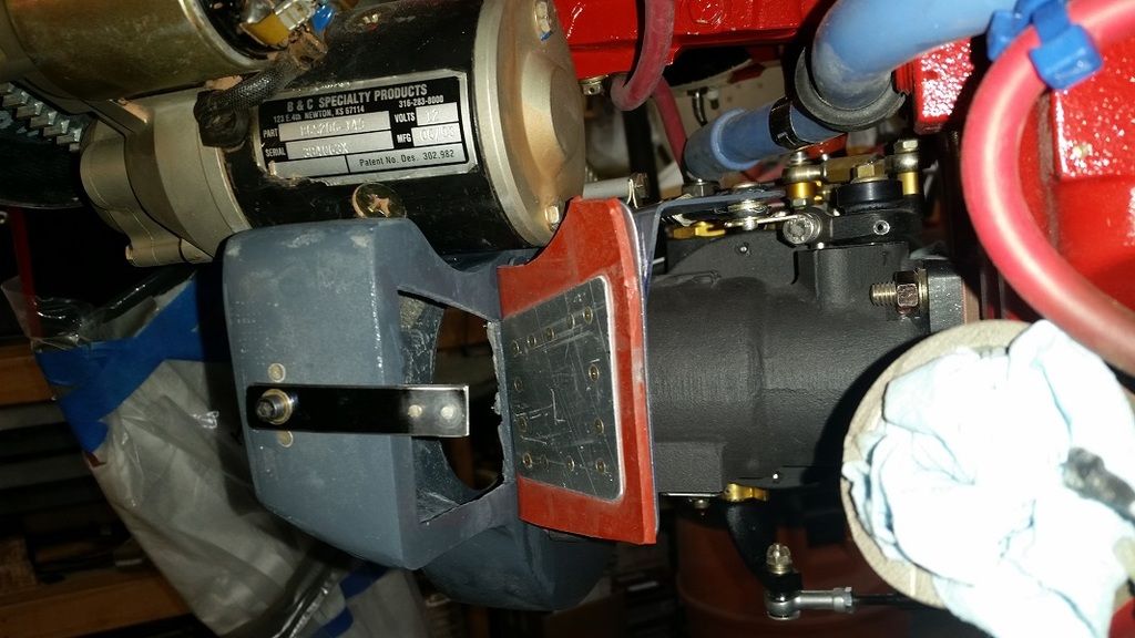

Well, it's interesting to see the range of responses. I absolutely see the " its only essential if you need it" view. I thought maybe I should have said mandatory - but even that seems to be contentious.
I guess on balance I will feel a bit uncomfortable about not having one. I'll see if I can engineer the space I need to get a side arm on the length of tubing between filter and adapter. Maybe shorten the nose cone a little, use a shorter filter. THe two things that are fixed and cannot be re-engineered are the location of the adapter on the front of the fuel servo and the location of the intake on the front of the cowling - the former can't move back and the latter can't move forward.
I'll see where I get to and post some photos.
Many thanks for all the comments.

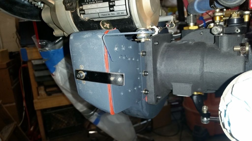

Howdy Chris,
This is how I did it:
I made an airbox out of fiberglass. I believe the filter is a 0995. The alt air door hinge/gasket is sheet silicone rubber stock. It is manually actuated. I had to put a spring steel strap with a ramped block on it to make it seal properly.
