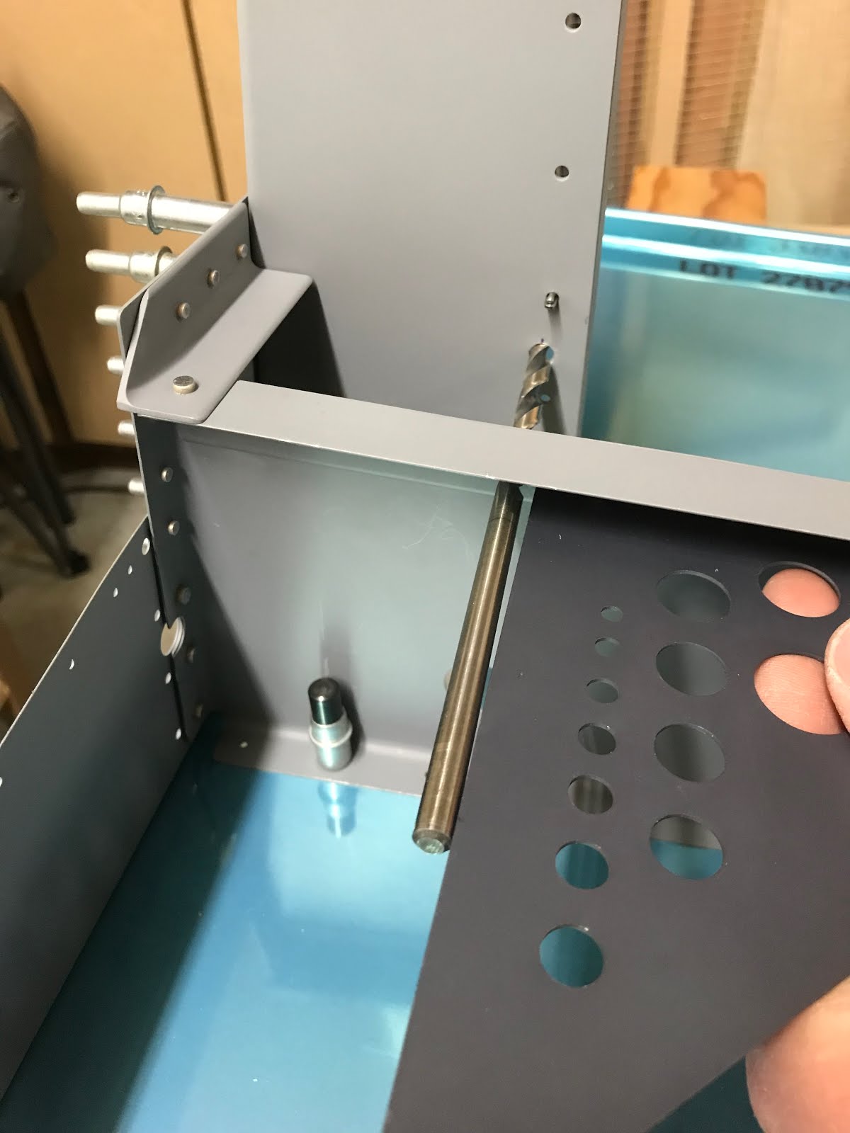

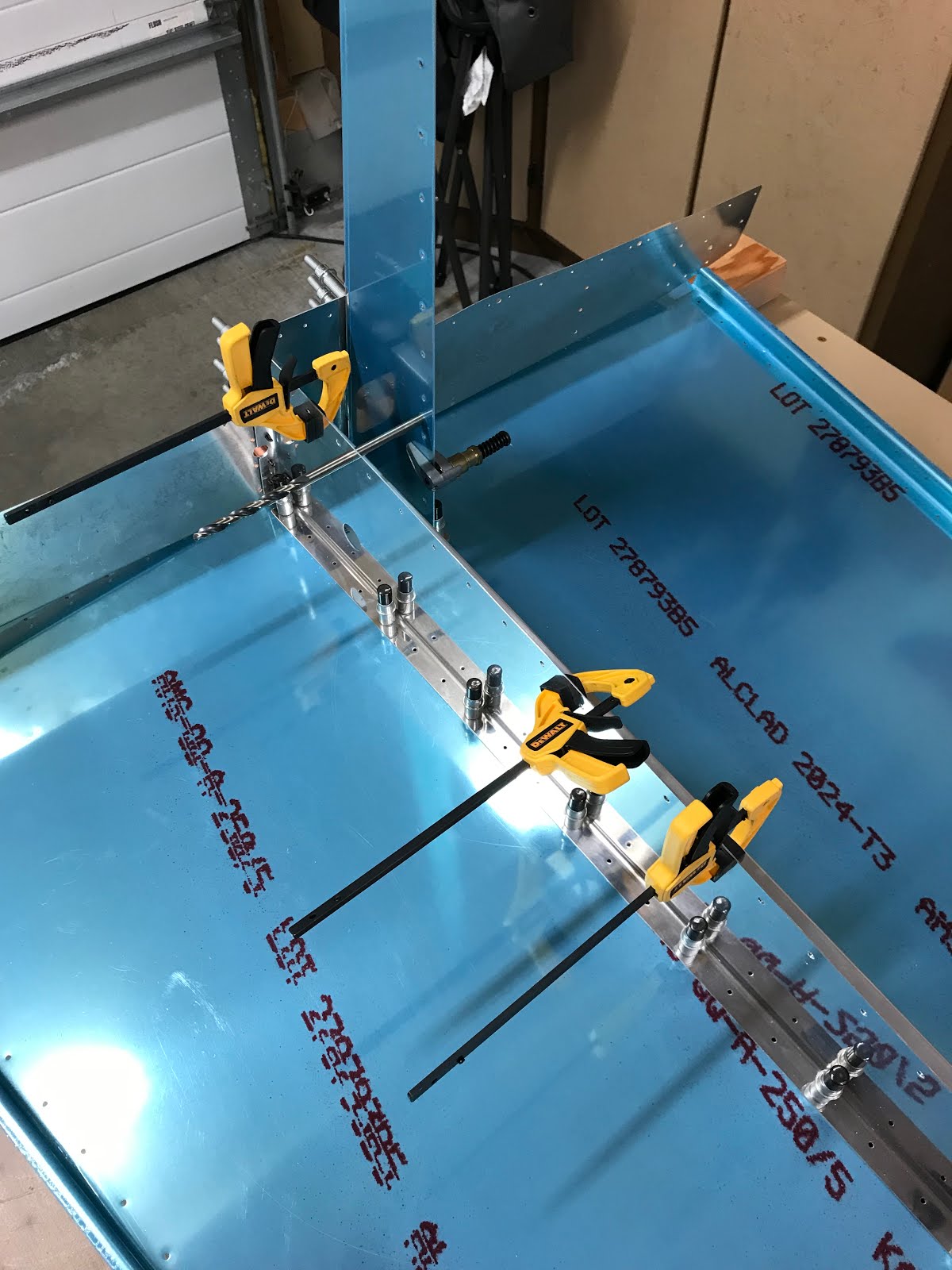

Anyone have issues with the alignment of the Elevator Bellcrank F-635 not being perpendicular to the longitudinal axis of the plane?
I'm currently working on the F-706 bulkhead and when I've drilled the 1/4" holes for the bellcrank in the F-728 and F-729 webs/angles, (See Dwg 26) the axis is not parallel to the F-729 rib. Axis is off by about 1/8" putting the bellcrank on quite an angle.
http://4.bp.blogspot.com/-zM-OIuMXJn...0/IMG_0981.JPG
I called vans and their suggestion was to re-drill the holes and add doublers. Since I'm so early in the fuse build, I decided to re-build F-706 bulkhead assembly again. On this second attempt. I haven't drilled the 1/4" holes in the F-728B and F-729B angles yet, however initial measurement of the Factory punched holes looks to still be out about 1/16" with everything built up on the second bulkhead.
http://4.bp.blogspot.com/-aeRR3OF8en...0/IMG_1089.JPG
Should be easy enough to spilt the difference and move one hole forward 1/32" and one hole backward 1/32".
What I'm thinking of doing is avoiding drilling the 1/4" holes in the angles/webs until the Fuselage is more assembled (Just before I have to rivet in the F-728 assembly) My thinking is this scenario will help ensure that the axis bolt can be drilled perpendicular to building lines with certainty.
Any thoughts or opinions?

I don't recall having an issue drilling the holes. You could release the clekos, drill the holes, bolt it with a bushing spacer then cleko the structure back together.
Hopefully the rivet holes won't be off.

I don't think the bellcrank mount bolt holes being misaligned fore/aft by only a 1/16th of an inch will be a problem.

Can drilling this location wait till the parts are in their final (riveted) position?

Well that's what I was hoping to do. I haven't seen a build log that someone has done this on, and since its different from Van's Instructions. I figured i'd try to gather some intel before I forge ahead breaking new ground.

Just got to this point and have same issue, built to spec per plans (riveted together) and holes don?t line up! I inserted a long .25 bolt to see alignment and disappointed with result unless once it ?aligns? itself when attached to the skins....it is a flimsy structure at this point. I?ll build other parts while I wait for tech support to return from Oskosh. I hope I don?t have to reorder the bulkhead as it was a fair amount of work.
