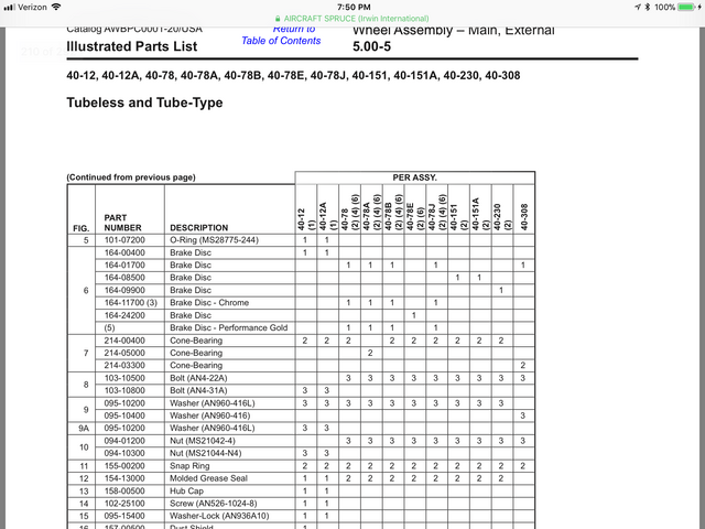

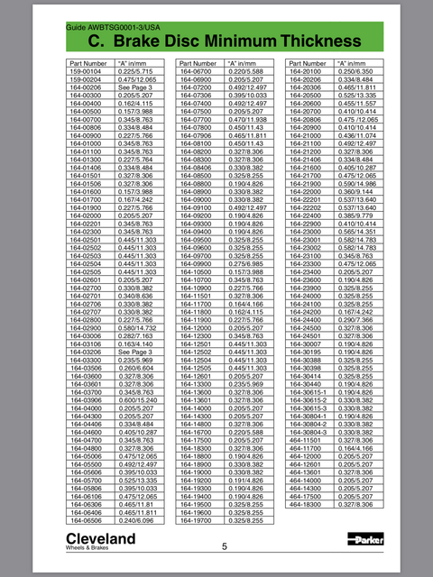

I need to turn my rotors but don't know the minimum thickness. I called Vans to ask but they don't know. They said there are 2 types of brands. I believe one is Matco and can't remember the other one. Unfortunately I don't know which brand I have. My 6 was built in 2000. If I could get the minimums for both brands that would be great so next time I remove the pants I'll already know.

Cleveland min thickness by part number. Part number is 164-01700. Min thickness is .167”.

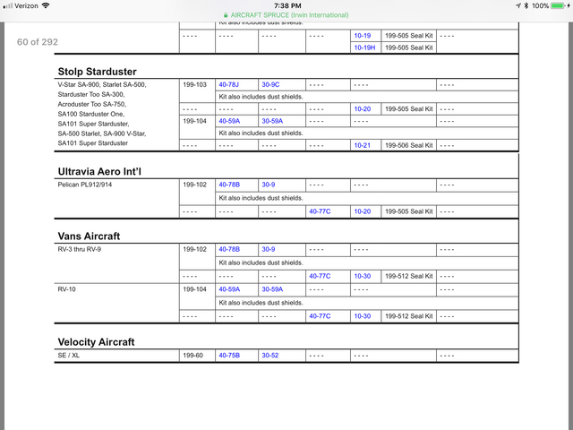

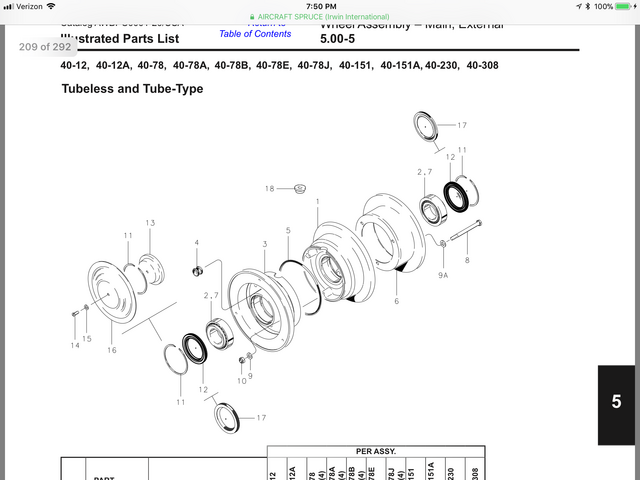

Likely Grove, but could be Cleveland. Each of the 3 companies lists their dimensions on line.
If you have Grove wheels and brakes be sure and buy original Grove pads, direct from Grove.
In my experience the RAPCO pads have very course embedded bronze chips that score and gouge rotors that would otherwise last for years with Grove pads.
Pull the pants and ID what you have. The short way is the long way.

No turning even with deep grooves in them...
https://www.parker.com/literature/WBtech.PDF
