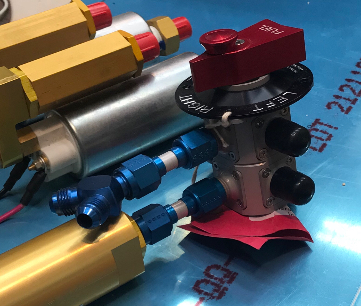

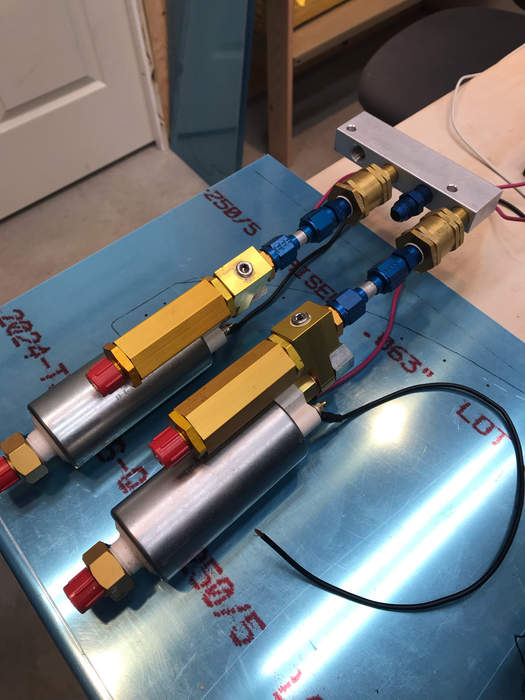

The bypass valve aspect of the regulator should serve as a check valve against this. You might consider replacing the regulator with a simpler fixed bypass valve nominally set to 25-30psi. The metering valve should tolerate a range of pressures. Airflow performance systems rely entirely on a high-quality bypass valves and don’t require regulators. The hexagonal brass colored bodies shown in this photo of the dual pump system I’m installing are bypass valves that feed back into the return lines.(I’m eliminating the engine drive pump, thus redundant electric pumps).
The bypass valveswill feed into the retur portion of the dual Andair valve via the wye-fitting shown here
