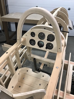

Default Building a wood seat
It was always stuck in my head that I wanted a cool cockpit. I wanted the cockpit to be as much like the real thing as I could. Why? Tell me that you don't love looking at the RV interior pictures! Everyone is always peaking inside the cockpit. At first I though about buying a wooden kids chair. I searched IKEA, then Amazon, Lowes, Home Depot. Nothing. I was forced to build my own seat. So I went to work, I was going to make it simple at first. But as I rolled into the construction. I just didn't impress. So I went to work. Cutting, sanding, cutting, trowing away pieces and cutting. By the end of it my kids were so annoyed with me because I kept asking them to sit in it so I could measure and check fit. In the end, I was pretty happy with how it turned out. Do you think Classic Aero would cover it?

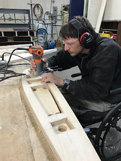

Default Assembling the Fuselage
Assembly of the fuselage was so much fun, but took an incredible amount of work. Its funny how things just slap together in your mind, but in real life - Not the case. Lots of painstaking work and measurements and router jigs were put into good use. I used very long strips of Douglas fir as stringers, clamping them to the sides of the bulkheads and marking locations. The amount of time taken to router all the pieces and get fitment anywhere near the Vans Kit took an unbelievable amount of time. (Really makes me appreciate my RV7A kit even more). I should make a special mention that I designed the entire plane with furniture style hardware so that the entire plane can be assembled and disassembled for transport. A special mention and thanks to my wife as I kicked her van out of the garage for the summer to make some room for the plane.
