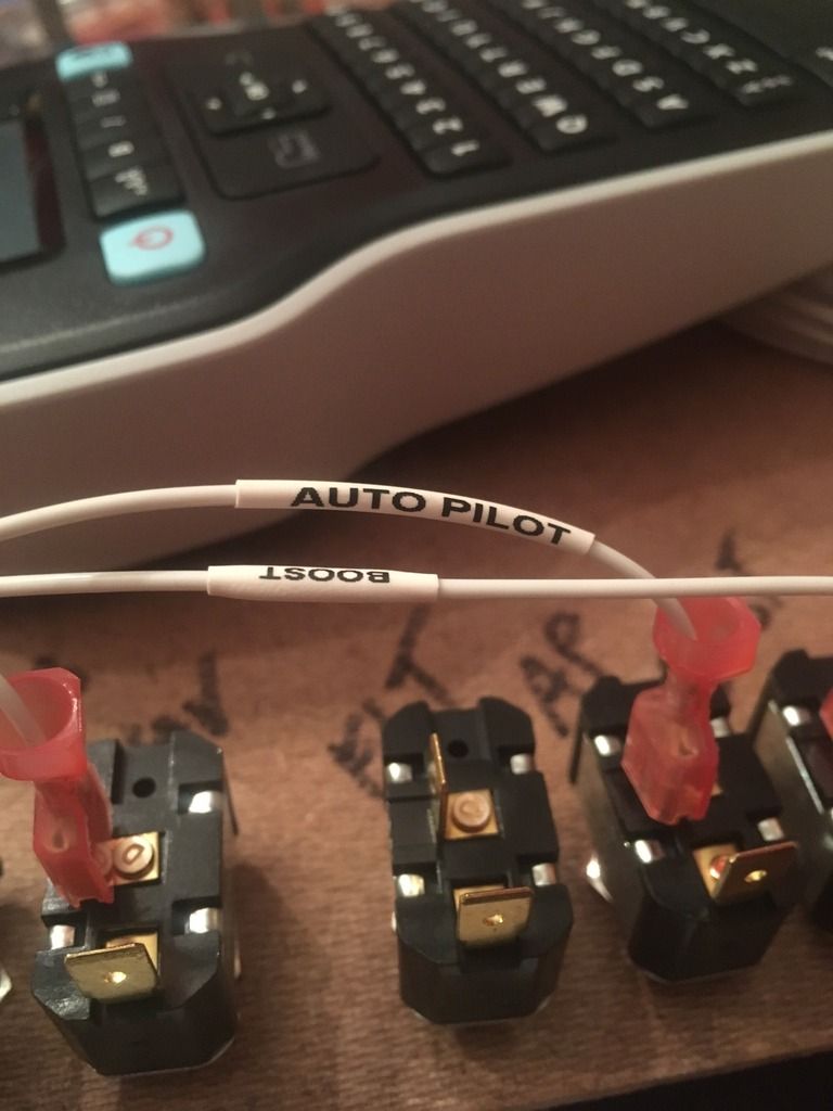

Thanks for all your input. I bought a Dymo LabelManager 160 for 20 bucks on Amazon, and 1/4? heat shrink label tubes. I was concerned that the 1/4? tubes would be too big for 20 gauge wire but it works perfectly.

RV10Pilot RV10Pilot is offline
Location: Medford, NJ USA

Rod,
The 1/4" tubing will do 22 gauge wire. I'm amazed at how much it will shrink.
Here's how it looks... sorry about the spelling
