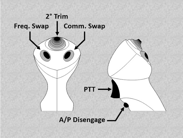

I used the discrete inputs on both the GTR-200 and the GMA-240/5, as shown below on my Tosten CS-8 stick legend image, when I wired my control column harness.
I left tails for the unused, second, discrete inputs in case I later decide I wanted to use them for something.
