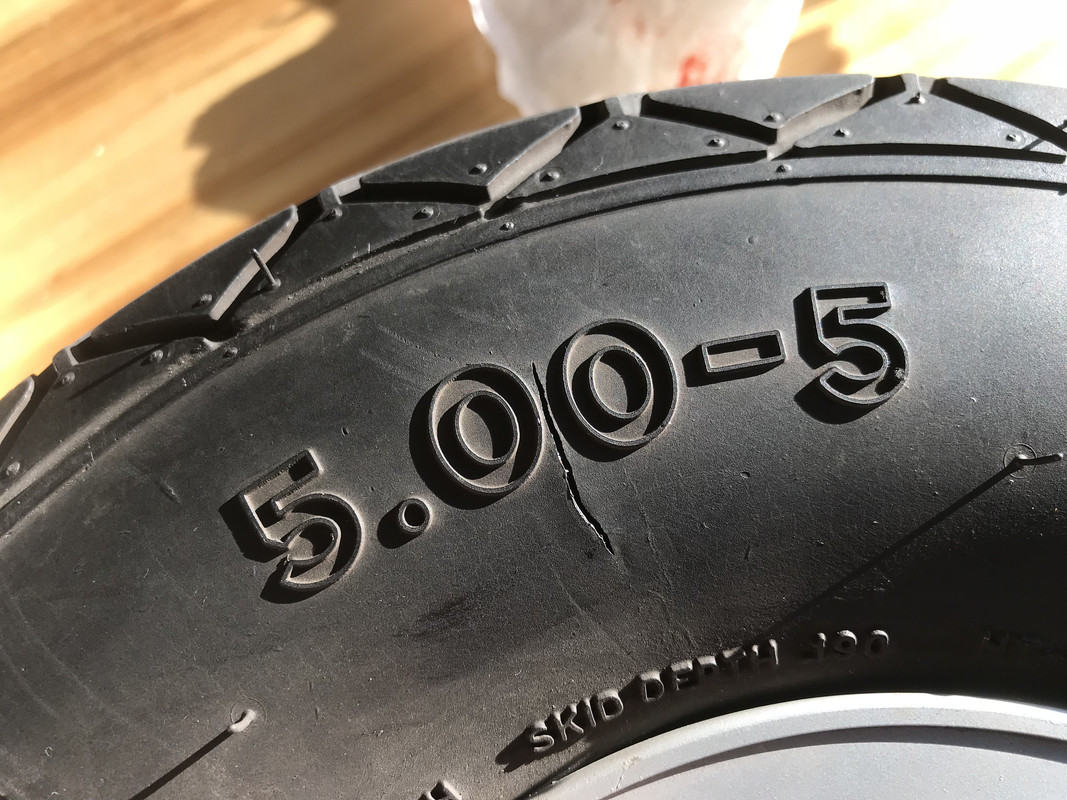

Hi guys, I’m just into my first annual and I’ve found this cut on the outside of the tire. It’s an inch long, does the necessitate a new tire?

I would change it out, better safe than sorry...

it seems as if the crack is looking around from between the O's O's. freaky.

Sidewalls don?t tolerate damage. I agree that this should be replaced.

At the airlines any sidewalk damage was cause for rejection. A big deal since those tires are very expensive and are typically recapped many times.
Sidewalk damage and tire was scrapped.

i dont see any wear on the tire - the little needle nubs are still present. The crack also seems to be following along some sort of flaw line in the rubber. Might look into getting the supplier to replace it on their nickle.

Take it from a guy that changed a tire on the rv8 in the dark on the ramp 900nm from home, it?s not fun, but I now own rv8 jack points.

I?ll replace the tire.

I?d see how deep it is, I?ve seem MFG defects from the mold that look like cuts are you sure it wasn?t there before?
