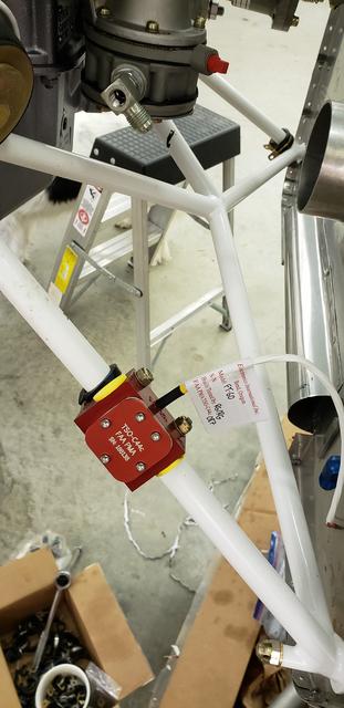

Carl Froehlich's Avatar
Join Date: Dec 2007
Posts: 2,587
I?ve posted on this before.
I installed the red cube in the RV-10 in the Van?s recommended postion - aft of the firewall in the tunnel. The boost pump does effect the reading when on, but over several years the accuracy has always been withing a half a gallon and the cube has never failed.
I?ve seen recent postings on RV-14 mounting locations and found they all tend to violate the red cube installation guidelines. I?m thinking heat and vibration are life limiting elements for the cube.
Just now working how to mount this in the new RV-8 project. I?m tempted to put it aft of the firewall but figured I?d try a spot between the engine fuel pump and the throttle body. It is hard to meet all the guidelines:
- straight fittings
- no mounting on the engine
- up slope
- away from heat
Here is the spot I found that meets the rules. I test fitted the 4 pipe exhaust and I have very good clearance so exhaust heat should not be a problem - but I may still put it inside some heat barrier material to shield against radiant heat.
Carl
