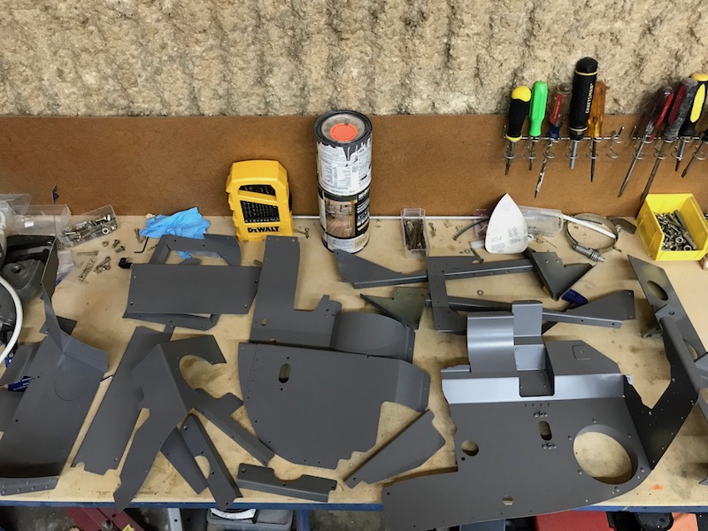

I used the RV-14 Baffles on my RV-8A powered by an XP400 and the fit is very good.
Bottom right of this photo shows the updated #3 aft baffle (upside down). Note the deep channel and the standoff.
