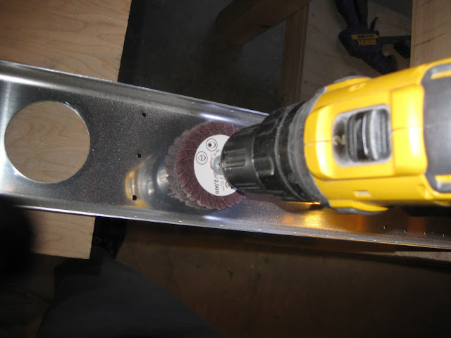

This isn't what you're asking for, but it's worth considering.
It makes lightening holes and edges a breeze. Works great for scuffing prior to priming too.
