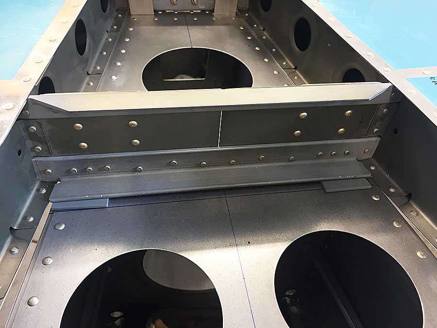

Today I trial fitted the horizontal stabilizer to the fuselage and something is very wrong

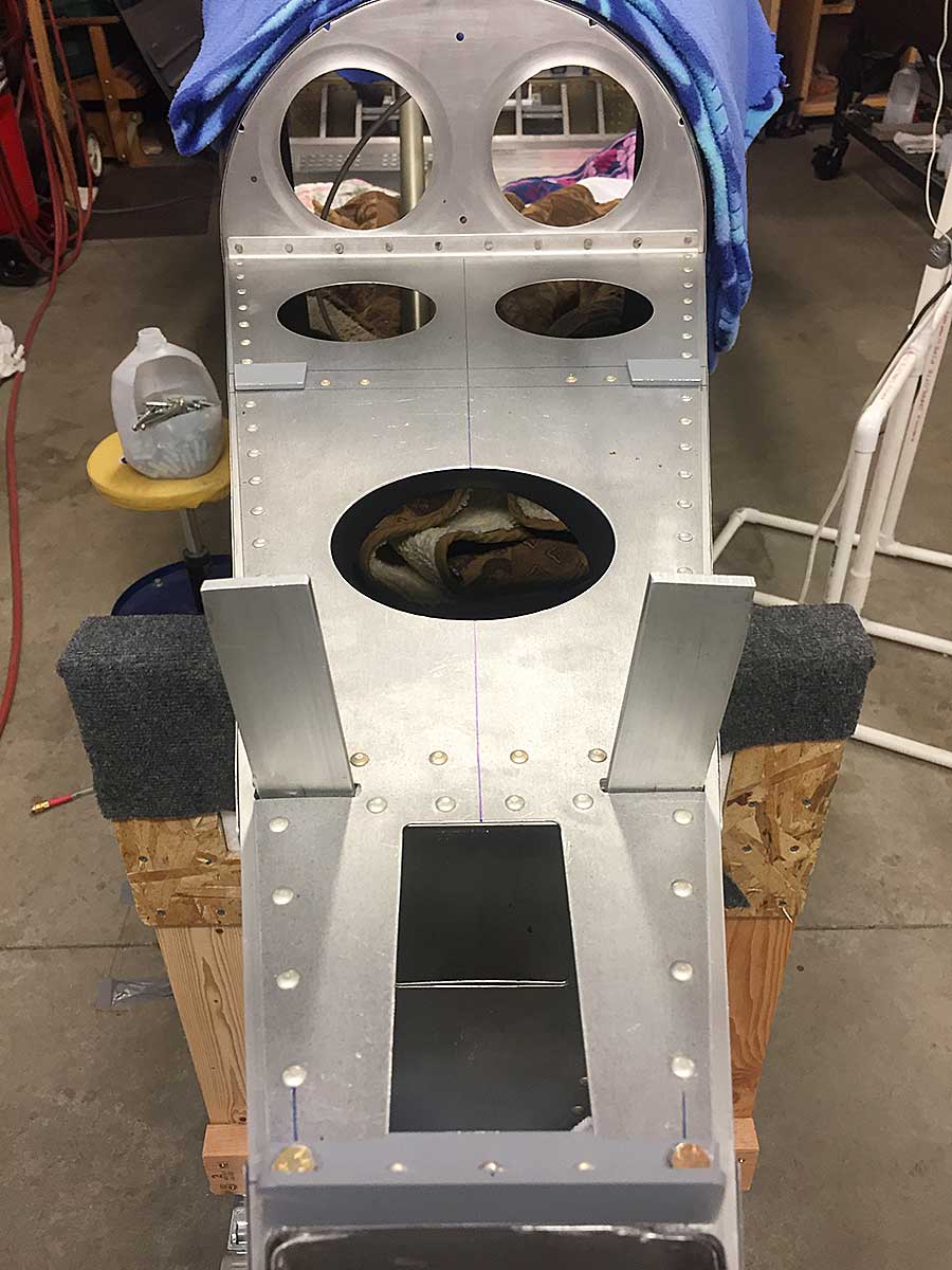

I started by drawing a centerline on the aft deck and then marking the F-710C spacer / F-710B angle on the top of the deck for reference.
As soon as I placed the stabilizer in position I could see the forward spar was way to far aft. 29/64" too far. That's over 7/16" of an inch too far aft.
I measured all the bits on the aft deck and they seem to be in all the correct places.

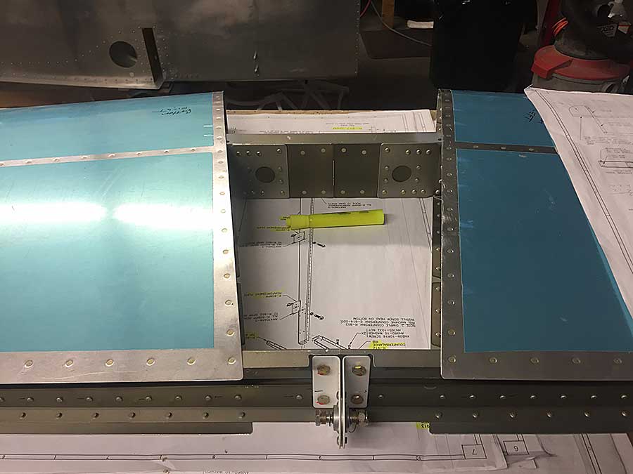

The horizontal stabilizer is more troubling. The forward spar seems to be too far aft. Neither Van's or I can figure out what mistake would end up with a misplaced spar...everything looks good compared to the plans except the spar is too far aft
There must be a mistake somewhere but darned if I can see where it is. We even entertained the idea that the stabilizer is not a -7...not sure how to tell.
Has anyone ever heard of such a thing??

Default Maybe a stupid question
When you mounted the horizontal stabilizer was the aft spar behind F-711C bars? I could see the forward spar sitting too far forward if the aft spar was in front of the F-711C bars. That flange would account for most of the space.
Check to make sure the F-711C bars are installed on the forward side of the F-712 bulkhead? Not likely to be the problem.
Your line appears to be in the correct location, based on the photo.

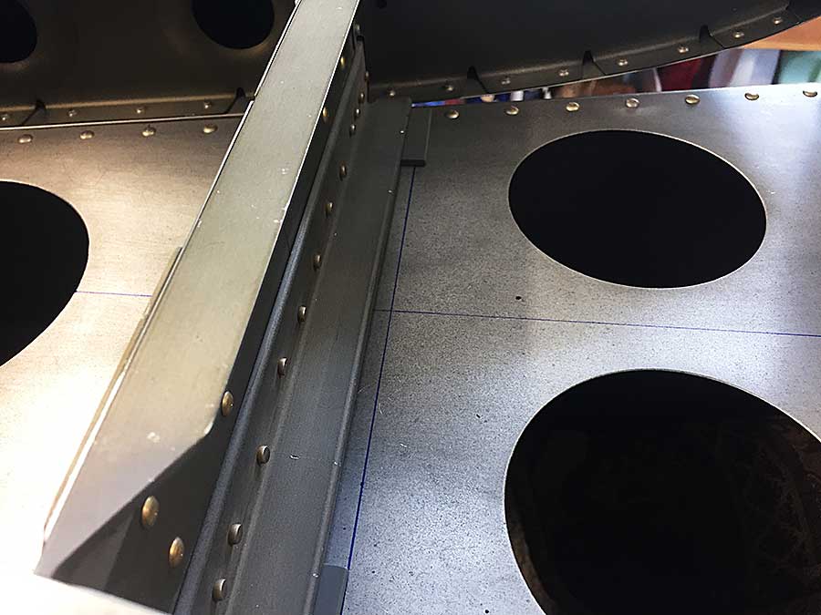

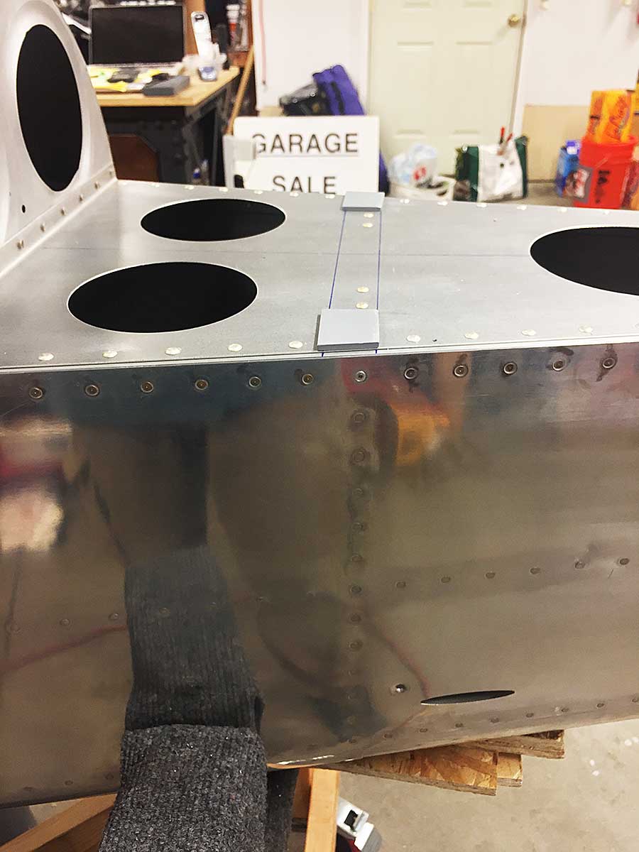

More photos:
Here's another angle with the stabilizer in position and sitting short of the line.
Looking at the aft deck...All measurements look good here.
F-711 bulkhead from the outside.
F-711 bulkhead from the inside...alls good as as I can tell.
The rear stabilizer spar.

Check that the distance from the front of the HS rear spar to the back of the HS front spar is 12 and 3/16 inch. If it is then your HS is correct. I think check this first, and then double check that you have actually drawn those lines in the correct place. On mine the distance from your front line ( forward part of the angle (F710B) on the F710 bulkhead) to the centre of the first rivet on the aft deck in front of your line is 5/8 inch, measured parallel to the F710B angle.
Hope it all makes sense, and helps
