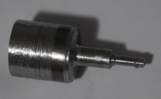

Now you guys are making me rethink my plan.
So, this is what comes out of the pressure regulator for a vapor return line:
It is sealed with an o-ring, the threads are 1/4x28tpi. Doesn't match any fitting standard I can find. The hole on the inside is sized for a post on the diaphram. The exterior is a hose barb for 1.8" hose. So, I need to get something out of this and back to the gas tank. I can't find 1/8" hose barb adaptors anywhere. 1/4" and up are everywhere.
My thought was to use nylon reinforced fuel line from the auto parts store, held on with a hose clamp. Put firesleeve over that.

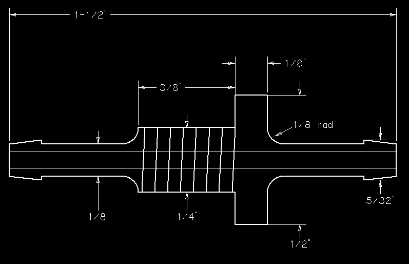

To get thru the firewall, make a steel bulkhead fitting like:
Not as fireproof as stainless, but would 1/8" mild steel hold up to a fire longer than 0.025 (or whatever the firewall is) stainless? Standard AN fittings don't come in stainless, so pretty much using regular steel everywhere else.
Run the same kind of hose back to the tank, don't need firesleeve behind the firewall. Adel clamp it to the existing fuel line for support. For the fuel tank end, make the same fitting without the interior barb.
This is how far I got today before my tools needed sharpening again:
Thinking about it again today, I could get some 416 stainless, try to make something that replaces the part coming out of the pressure regulator. Make it have the 1/4" inside with an o-ring, then have a 37 degree flare on the outside for -3 hose. Could then use standard AN fittings and 3003 tube back to the tank. Would need to get the 3003 in place inside the cockput, would be a chore.

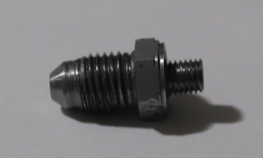

So, being on call and unable to go to the airport, still got some shop time in:
The compression fitting end held air pressure before I drilled the hole all the way through, the O-ring should be here Tuesday. Will be able to see if it holds fuel after everything is hooked up.
This 416 stainless is really easy to cut. Much easier than the mystery metal mild steel I had been using before. Going to buy the proper alloys from now on.

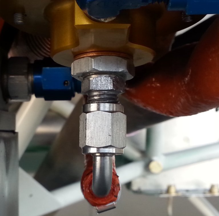

And installed:
Got it in Saturday, but waited till today for the sealant to harden up before testing. As per Rotec's instructions, didn't install any other restrictions between the fitting and the tank (drilled mine out to the same 1/16" size as theirs).
With the boost pump on, get about 21gph going back to the tank. Too much? Well, I tried it on the ground, got up to an oil temperature of 195 without any problems running full power. Oil didn't get hotter (air only about 80 degrees, the summer heat has past) even with extended ground runs.
So, time to see if it flies. Yep, flies no problem, even after extended ground runs left the engine very hot.
With it pumping that much back to the tank, I will need to be sure to use that tank first and only run the other for short periods after the main has emptied a bit. Did that in flight today, did about 90% on the right (return line tank) and 10% on the left, landed with about the same in both.
May want to add some more restriction to that line.
