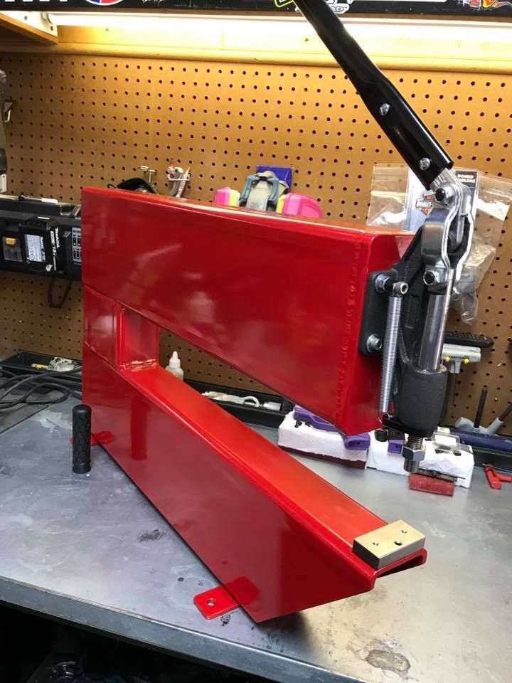

I built this one much like you did yours. I had some 7x3x.250 steel laying around and used it. It should have less flex, so all good. I also drilled and tapped the face while I had it on the mill. Then powder coated in gas can red
[IMG][/IMG]
