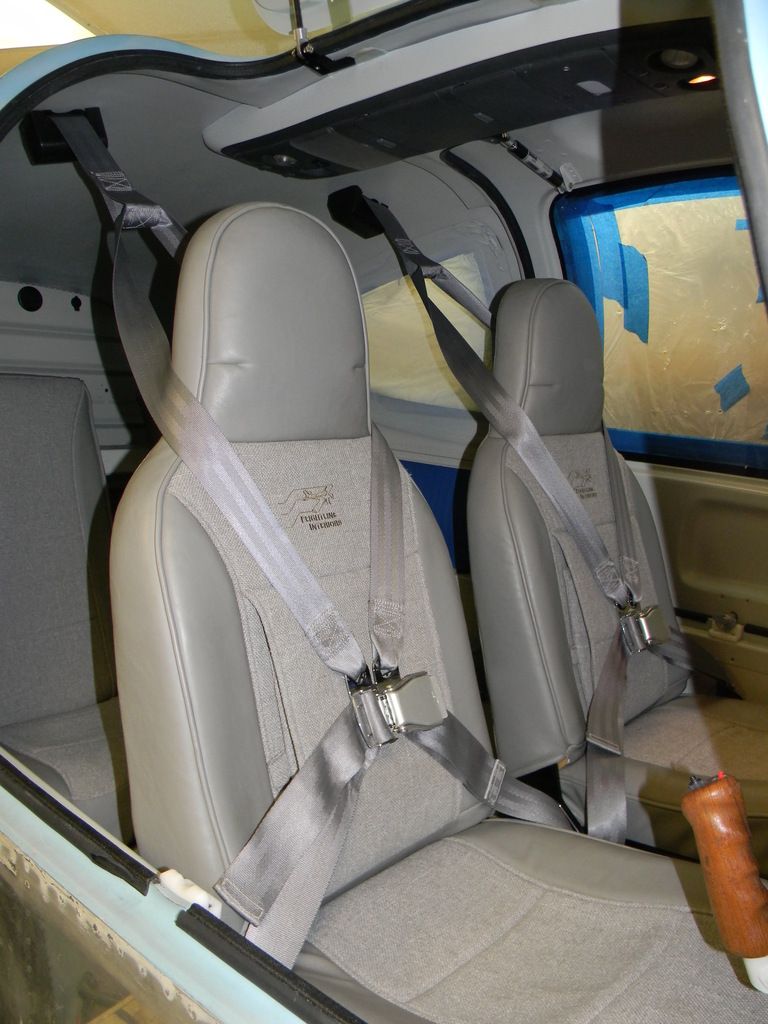

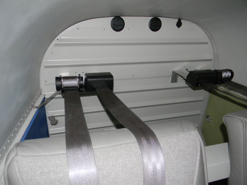

These seatbelts came out of a Cirrus that the owner changed color. They are AmSafe belts and fit my -10 perfect. The rears were a little challenging to install. Initially I had the inertia reels forward of the rear baggage panel. Decided to fabricate brackets to mount them aft of the baggage panel after I saw how much baggage room they took up.
The fronts were bolt on and the reels bolted directly to the cabin top, so they are up out of the way.
