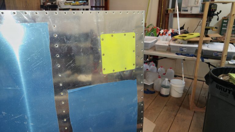

Anyone else notice that the fit of the left leading edge access panel (the one for the stall warning mechanism) is a little off? There is about an 1/8" gap all around the access panel. All the holes line up fine and it's on the bottom of the wing so no biggie. It's only cosmetic.
I could also make my own that fits better but I'm just surprised because everything else fits so well so whenever something doesn't fit just perfectly I assume I did something wrong!

I think it depends on how much material you end up removing to smooth the edges. Mine (on the -10) has a similar gap (but not nearly as much as 1/8"). I'm not super happy with mine because I didn't do a very good job rounding the corners to match the inspection hole corner radii, but if it continues to bother me, I can always make another inspection cover.

I had the same issue with mine on the 8. Before I even de-burred the edges of the access panel, the fit was sloppy, with a large gap all around. I fabricated a new one that turned out marginally better.

Mine fit like yours. I just fabricated a replacement that fit much better. Just used the opening to trace out a new piece. I also used soft rivets to fill in the stall warning installation holes since I?m going with AOA...
I wonder why they had so much of a gap built in that panel?

Same here, made my own, twice!
Factory part fit was not to my standards.
