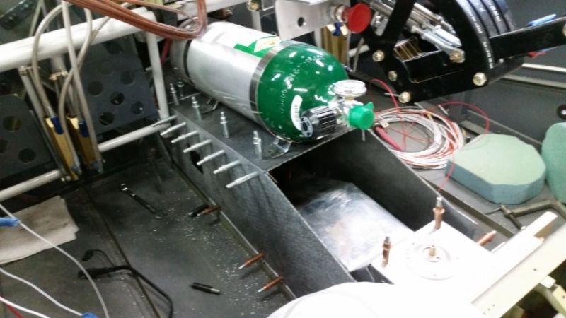

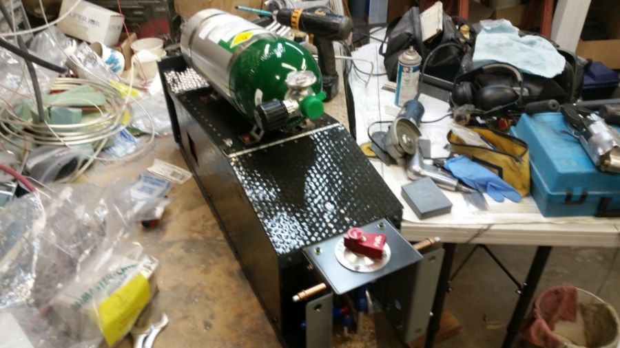

One thing that helps is to make a spot between the pilot and passenger's rudder pedals to securely store heavy stuff like a tool bag, extra qts of oil, etc. I made a box there and mounted my O2 bottle on top of it. Doubles as a glove box for nasal cannulas, pulse ox, etc. When you have lots of baggage, make sure you put as much of the heavy stuff as far forward as you can. I've been known to use an airbed as a booster under my wife's seat. 12 lbs on the cg instead of behind the seat.

You wouldn't happen to have any photos of that would you? I'd like to consider something like that for my own build.

Mine is a 6 with a parallel valve IO-360 engine and Whirlwind 74 RV. I put an auxiliary fuel tank behind the passenger seat and couldn't afford the aft weight and space to put the Oxygen back there too. I also have a second battery right behind the firewall which I enclosed in the O2/glove box.
I laid up the carbon fiber sheets under vacuum with hexcell to make it a bit thicker and stronger, then just made the box with hinge material as if it were sheet metal. I glued and riveted. The top will come off by pulling pins so I can get in there to change the battery and service the fuel pump/filter assembly. I push my toolkit all the way forward on top of the battery. I have a tag on it so I can easily pull it back out.
When we want oxygen, it is easy to grab the cannulas, in zip loc bags, out of the glove box, hook it up and get it flowing. The valve is accessible without effort. I like this location much better than behind the seat where I had it temporarily in our 6A. I pull the bottle and clamps to save 12lbs. when I don't expect to need the O2. I do usually pump the aux fuel into a main as soon as I can make room for it, and I have landed with fuel in the aux and a bunch of baggage without the dreaded aft CG sloppy stick issue. Did that once in the 6A and that was the day the tools moved forward. ;-)
Ed Holyoke
