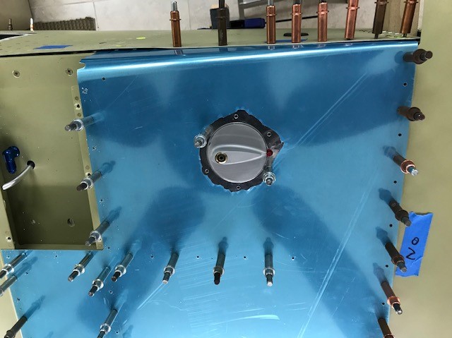

I have just installed one of these into my RV 3 as part of the build and wondering what I might be missing too. Installation is straight forward and it's probably worthwhile to get the drilling template to save some time ( I made my own template). It could use a shim under the main body as it is slightly proud of the skin on the outside when screwed in.
The screening capability is very generous with a pleated filter and for a carbed engine is more than adequate.
The only thing I am not really happy with is the plunger fuel cut off (the red button) which also serves to lock and retain the gascolator cap/filter, whilst it is all very well made, accurate and clicks into place nicely it is quite a small indent and groove that retains it in place. If for any remote reason it pops out there will be no fuel... I am thinking about removing the plunger as the gascolator (my installation) is after the fuel selector anyway.
I am still some time away from running fuel through it but I think it will be good.
Yes, red cube instructions say after all pumps however in anticipation of limited space and access forward of the firewall I have put it here, if in the future accuracy is not acceptable I will move it.
[IMG][/IMG][IMG][/IMG]
I put this unit in the M2 almost a year ago, not long after they came out. I took mine apart, but if I rem correctly the plunger installs from the top under the dome cap. Theres no way it can come out the bottom of the unit as theres a shoulder that stops its downward travel. I think I rem there are orings in there as well, and if you remove the plunger, fuel will come out. Might want to check on that......

Had mine apart too, it's the small size of the shoulder that bothers me. Probably wrong to say remove the plunger, rather better (to say) satisfying myself that it will never ever compromise fuel delivery.

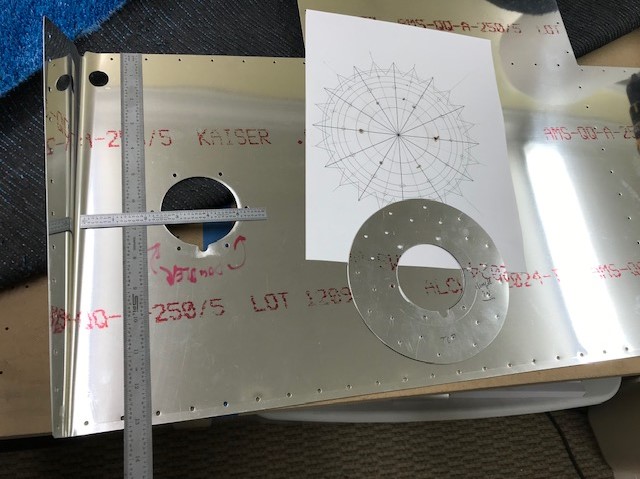

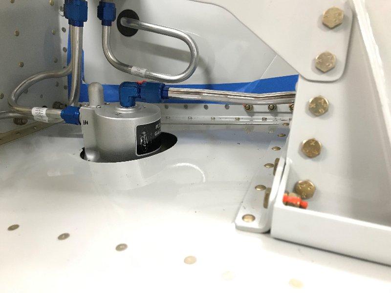

Thought I would post a couple photos of my installation. I added a circular doubler to the belly skin. The unit installs from the inside, so the floor panel hole has to be big enough to clear the whole flange. you can see the two pre-punched holes in the floor panel that give you an idea of the location of the hole in the floor panel. I will add some foam around the hole to keep anything from falling in and being lost forever! Just have some packing paper stuffed in there now.
a little Visio pattern for the doubler layout and some scales showing the approximate location of the cutout.
