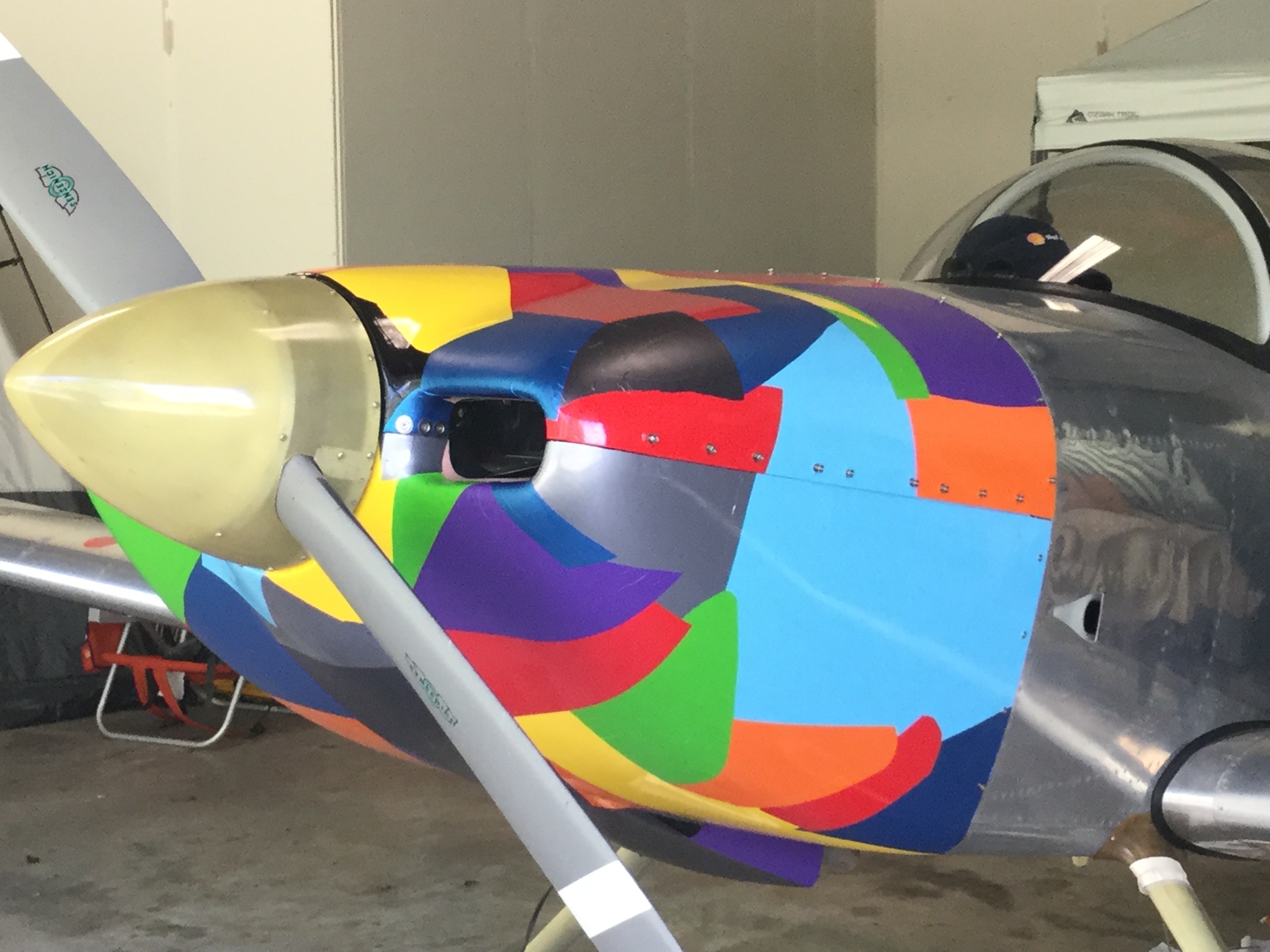

Originally Posted by spatsch View Post
I did use the end roll piece approach to vinyl wrapping and had my kids cut them before applying (nice family project ...):
my EAA chapter calls me now patches.... .
In terms of learnings:
- I did learn that it's more difficult to wrap many small pieces of vinyl around a compound curve then one large pieces. ( see by the wrinkles in the picture ). There is just nothing to hold on to on small pieces to stretch the vinyl.
- I have been flying with that cowling now for 2 years and I do think that I have to replace the vinyl. The problem is that on the top of the cowling the vinyl looks good when cold but when hot (after flying on a hot day) I get lots of air bubbles which disappear again when cold. This constant expansion/contraction can't be good for the vinyl.
My problem of course is that I like the design now and painting all those patches is a lot of work ... .
Oliver
Wait a minute... the Partridge Family built an RV?
NOTE: Old guys will get it. Youngin's will have to google it (the bus specifically) LOL

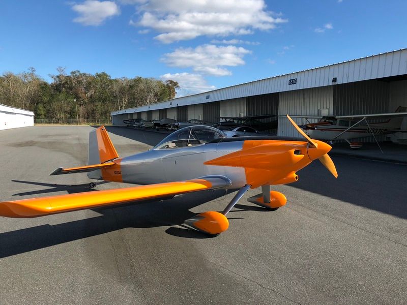

Here is my vinyl project, only things painted are the wing root fairings. The wheel pants are an experiment using scraps, I will redo them at a later date but at ten yards you can?t see the seams. Very happy with vinyl.
